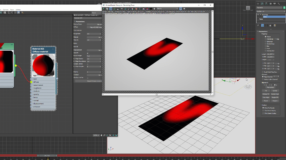

Hello. I ran into a problem with texture synchronization with the octane and 3d max viewports-please help me

Hi Goldisart,
I sent the issue to the developers.
A workaround is animating the UVW Map gizmo.

thank you I completely missed this animation option
