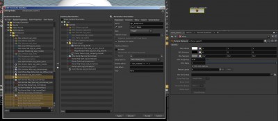

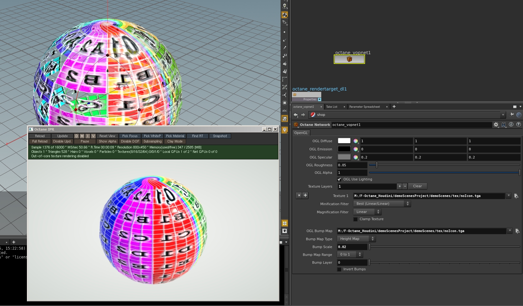

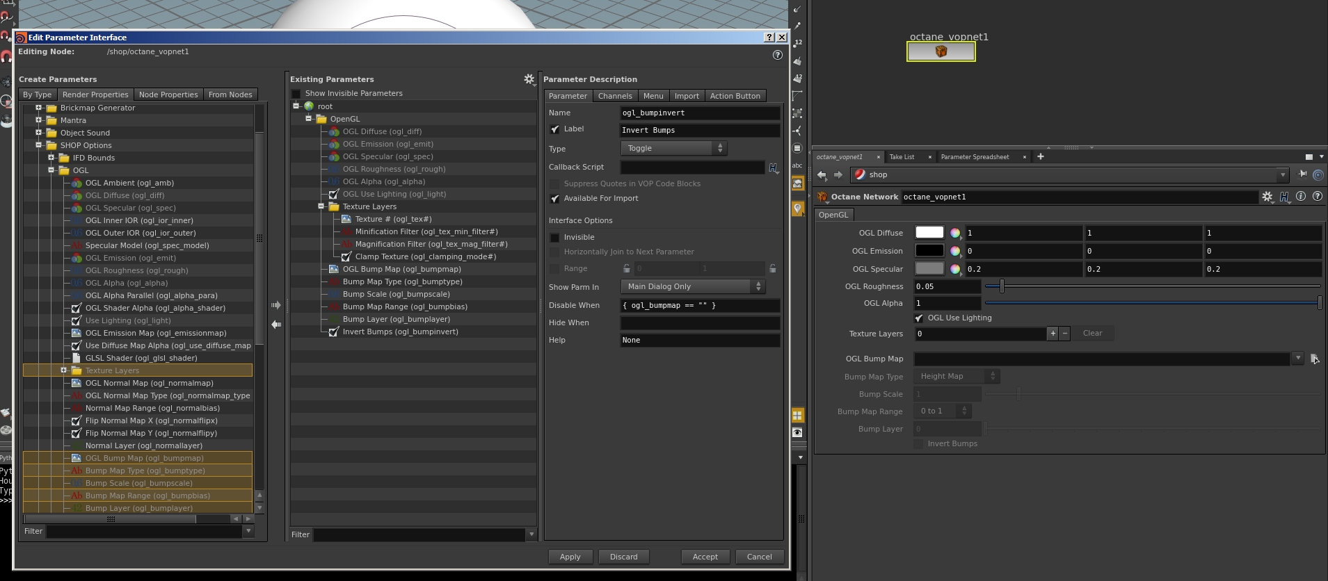

It is fairly easy add to the Octane vopnet node the parameters related to the OpenGL viewports. Now it only has some basic OGL parameters, but it is easy add more using the parameters interface (from the Render Properties tab, SHOP Options, OGL), and even link them to the internal Octane VOP nodes.
Anyway for a future release I want to improve the default Octane Materials HDAs, adding some internal texture nodes linked to the OpenGL viewport parameters ... but as you can see in the attached image, it is easy build your own HDAs with any kind of feature you could need, in this case support of color and bump texture maps in the viewports. The only issue is that the texture mapping is to going to work only over UV mapped objects, the Octane texture projections can't be supported in the OGL viewports.

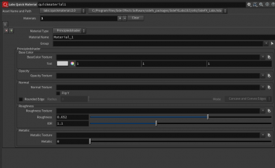

It'd be good to setup a basic interface on the Octane Material Builder like Labs Quick material for example (needs to expose a few more things, displacement etc)
Tried setting these OGL parameters myself but getting inconsistent behaviour in the viewport, sometimes it shows up sometimes not. Think its getting overwritten by the basic OGL colour parameters already on there.
