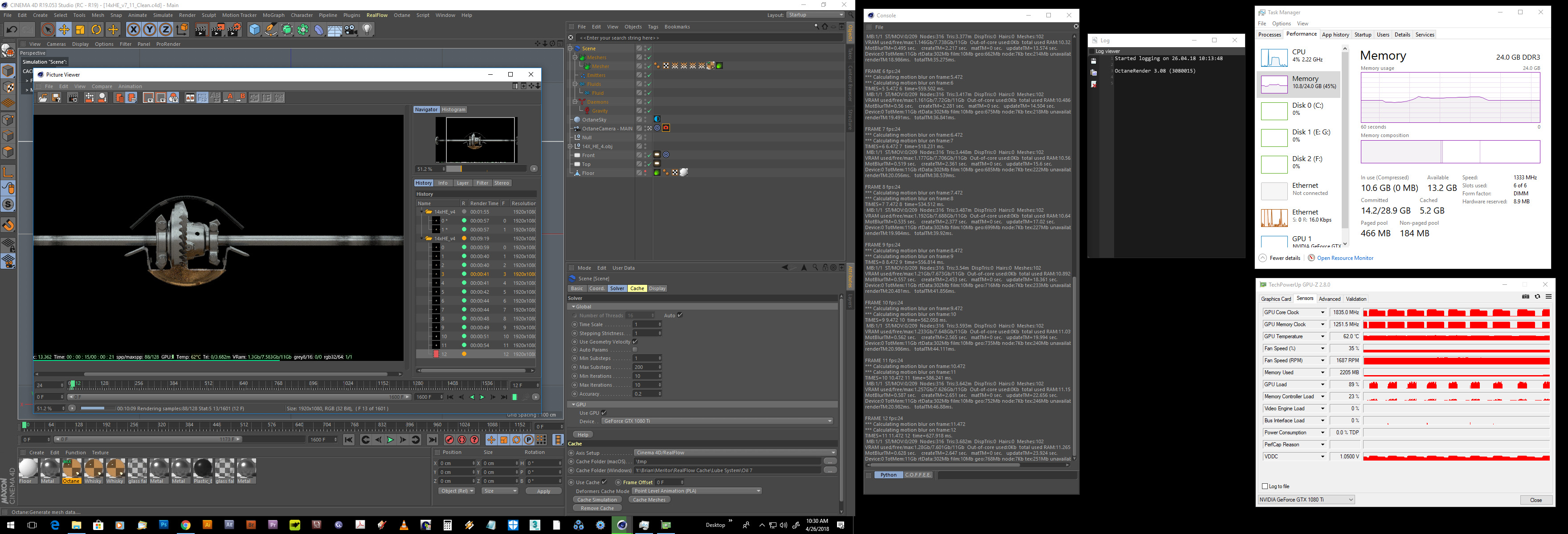

H. Rendering project in Picture Viewer updateTM starts high and keeps climbing. Fluid is fully cached.
Would appreciate any help, thanks!
Brian_S
Posts: 5
Joined: Wed Jul 26, 2017 8:14 pm
I'm at frame 26 now and the updateTM is at 63 seconds and climbing.
If more information is need let me know.
-Thanks
