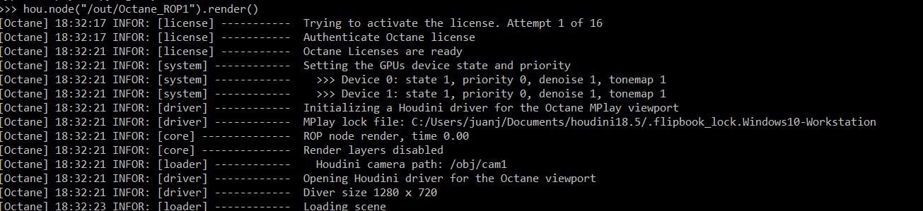

This is weird because although it is true that just one instance of Octane can be executing its activation at a time, the plugin has a loop to retry the activation up to 16 times if it fails. Can you please attach the full output of hython to the terminal when the activation fails?

You can spawn as many parallel octane instances as you want. The problem is that the license authentication only can happen once a time, so probably this is the problem that you have: multiple octane instances trying to authenticate the license at the same time.
As I've said, the plugin can retry the license authentication if it fails, but perhaps if you are launching so many instances at the same time, one or several instances could not reach the authentication before giving up after the 16 tries loop.
