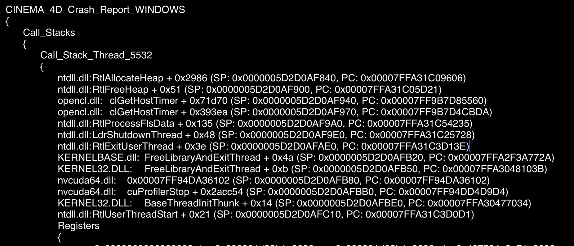

Also, tried rebuilding the scene (much simpler) and received this error a few times
Hope it helps
Hope it helps
- Attachments
- _BugReport.txt
- (406.42 KiB) Downloaded 216 times

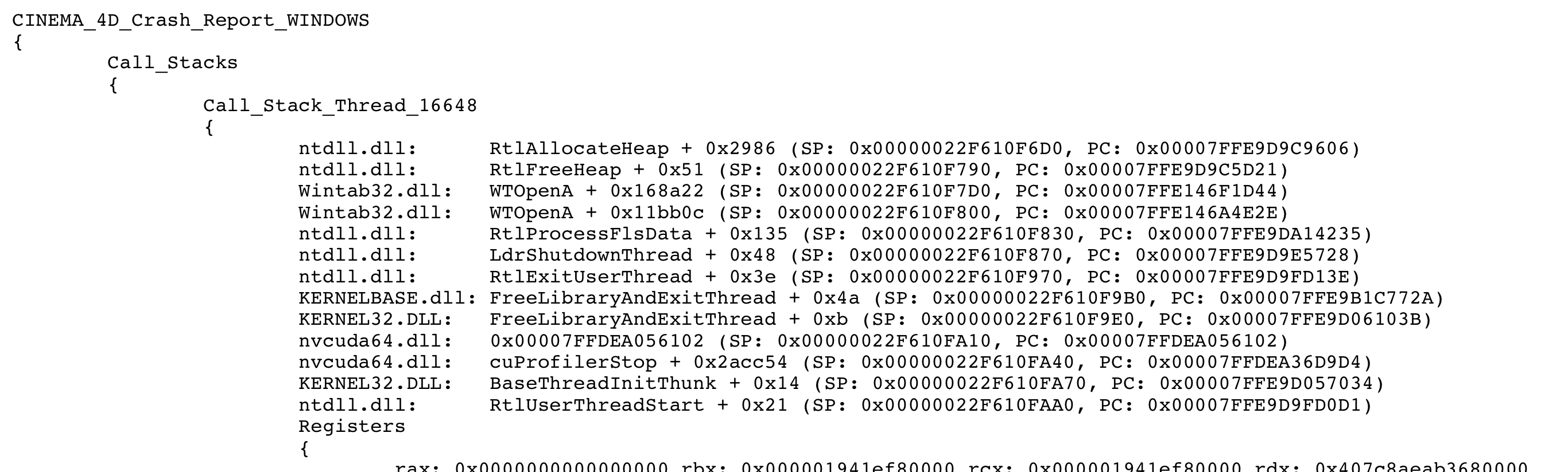

My tablet driver is up to date, Tried the alternate driver and still crashes on loading
Attached latest bug report
- Attachments
- _BugReport.txt
- (414.57 KiB) Downloaded 191 times
