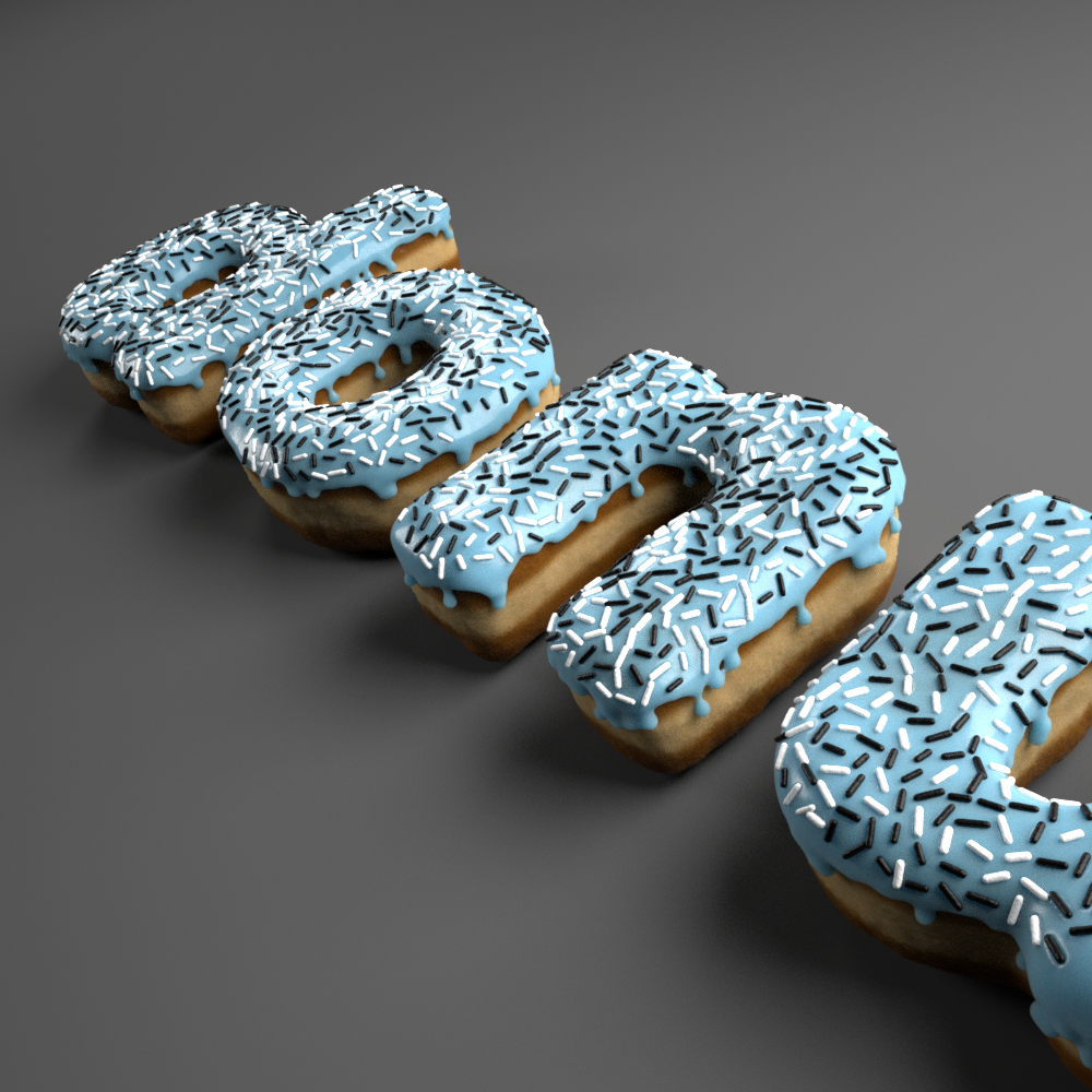

Hi Juanjo,
I was just playing around with the new Packed Geo Instancing functionality and am happy to see this making its way into Octane. Thanks for your work on this! I have a couple of suggestions regarding future development, but forgive me if they're already on the to-do list.
It seems that the packed instances don't get picked up by Octane when they're merged with other geometry in the same geo node (example attached). I'm not sure if this workflow even makes sense and it might be generally better to separate the packed geo into it's own geo node, but I wanted to better understand if the Octane packed geo instancing functionality will be able to accommodate for this use case at some point. I've been working on building an HDA to create donut type and would love to be able to instance the sprinkles as it can become a lot of geo to pass to Octane, but as I have everything in a single geo node it's not currently possible to use this feature.
Also, it seems that Octane won't render a material on the Octane instances if that material is added via a material node within the geo node. It will only render a material if you add it via the Render tab on the geo node itself.
Thanks!
Travis

Currently, it is not possible to mix conventional geometry and instances in the same OBJ node. The Octane plugin only can render one object type in each OBJ node.trogers wrote: It seems that the packed instances don't get picked up by Octane when they're merged with other geometry in the same geo node (example attached). I'm not sure if this workflow even makes sense and it might be generally better to separate the packed geo into it's own geo node, but I wanted to better understand if the Octane packed geo instancing functionality will be able to accommodate for this use case at some point. I've been working on building an HDA to create donut type and would love to be able to instance the sprinkles as it can become a lot of geo to pass to Octane, but as I have everything in a single geo node it's not currently possible to use this feature.
About your second question, I'm afraid that this is a known limitation. The instances don't support material overrides to assign a material to each instance. Perhaps this core limitation could be implemented on the plugin side ... I'll think about it.
Thanks,
-Juanjo
