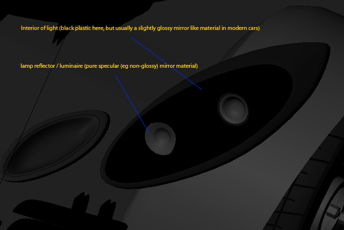

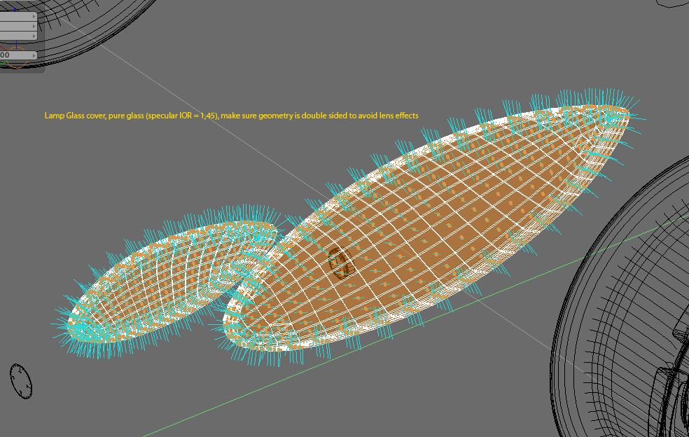

Hi guys,
Here's some information about the headlights.
Basically the most important thing is to have double sided geometry on the glass covers of the lights, so you don't get a lens effect. (just like car windows)
Commercial models usually don't have this, so i manually extrude them and make sure the normals are always pointing outwards on all sides.
This will give you a straight transparency as is required instead of creating a lens and having a strange looking headlight.
For the interior i usually just use mirrors or in this case black plastic as in the original car.

Ah. I see. I give the double sided glass a shot, though I'm still having a few issues i think with the lights themselves. I'll post in the WIP and see if I can get it sorted out.
Thanks!
