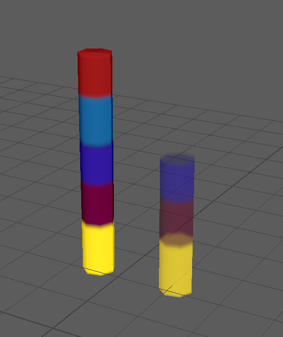

I have had trouble making vertex opacity work.
I read that in RC6 there was support for rgb and rgba. Vertex Color has been working for me for a while now except opacity.
Attaching a file with some test geometry. The image below is what I'm expecting to see (the screenshot is from MAYA)
However when I import the alembic files in Octane the opacity does not behave properly.
The left tubes are exported with "rgba" the tubes on the right are exported with separated alpha "rgb" and "opacity"
While the color information works I cannot seem to get the opacity to work.

This is a limitation, because textures can only produce a spectrum, an RGB color or a greyscale value the alpha component of RGBA attributes will be ignored. If you need it it needs to be exported as a separate greyscale/float attribute.Goro wrote:I have had trouble making vertex opacity work.

Apologies for not mentioning it in the release notes, which I just fixed.
Yes that was what I was thinking in terms of using RGBA however the second example to the right was exported with separate float attribute for the alpha "opacity".
It used to work in an earlier build from 2019 when I tested vertex colors in octane standalone when it was first supported.
So second export has "rgb" for color, and "opacity" for greyscale. Both exports are included in the attached orbx.
I had a look a the scene and the file "tube_opacity.abc" has a vertex attribute array "opacity" of type float64 (double). As we currently don't support float64 attributes, it doesn't get loaded.Goro wrote:Yes that was what I was thinking in terms of using RGBA however the second example to the right was exported with separate float attribute for the alpha "opacity".
From where is this file exported and do you've got any control with which data type float vertex attributes are exported?
