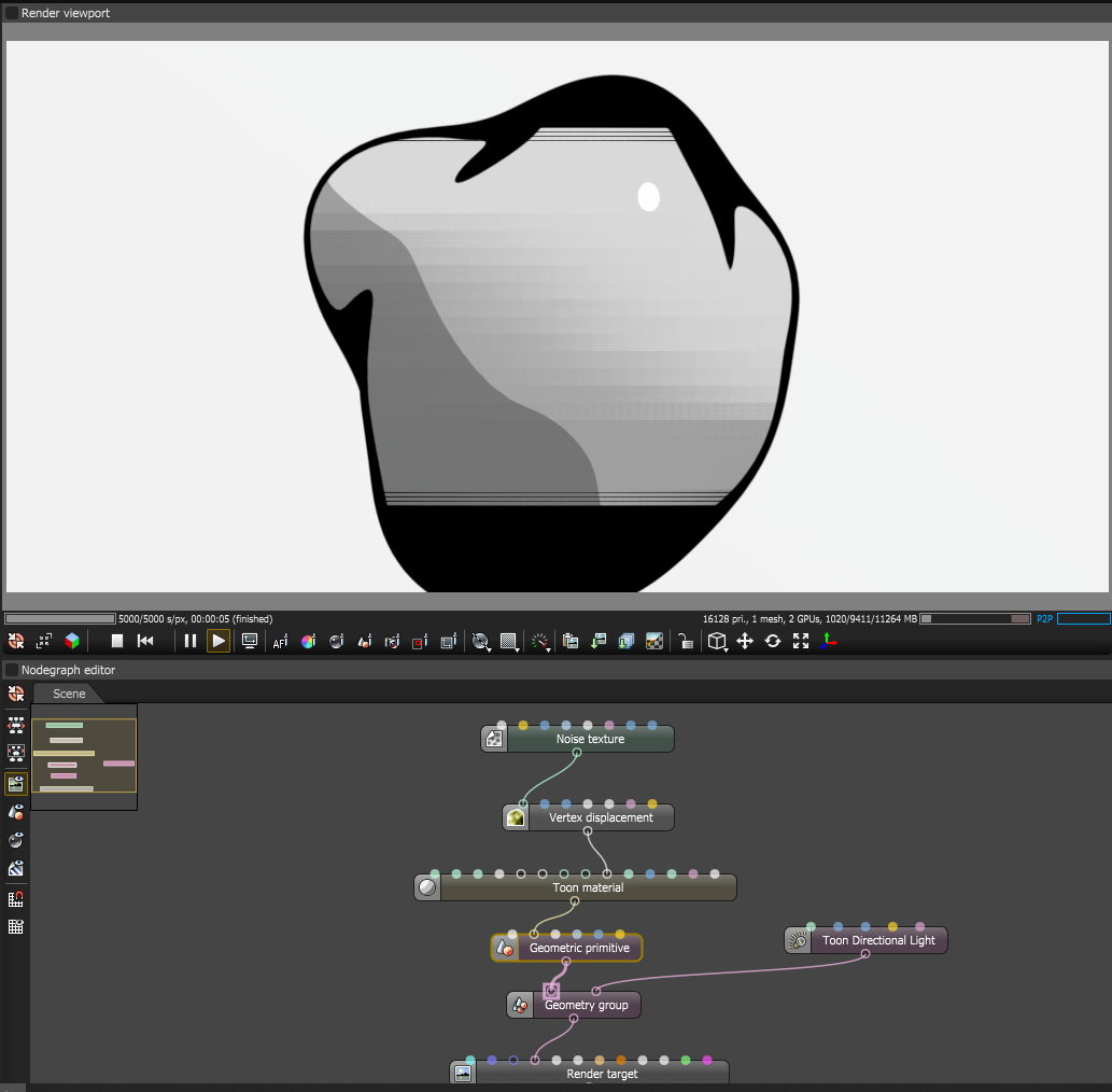

Toon Material currently shows artifacts when Displacement is used:
Last edited by linograndiotoy on Mon Jan 25, 2021 9:56 pm, edited 1 time in total.
