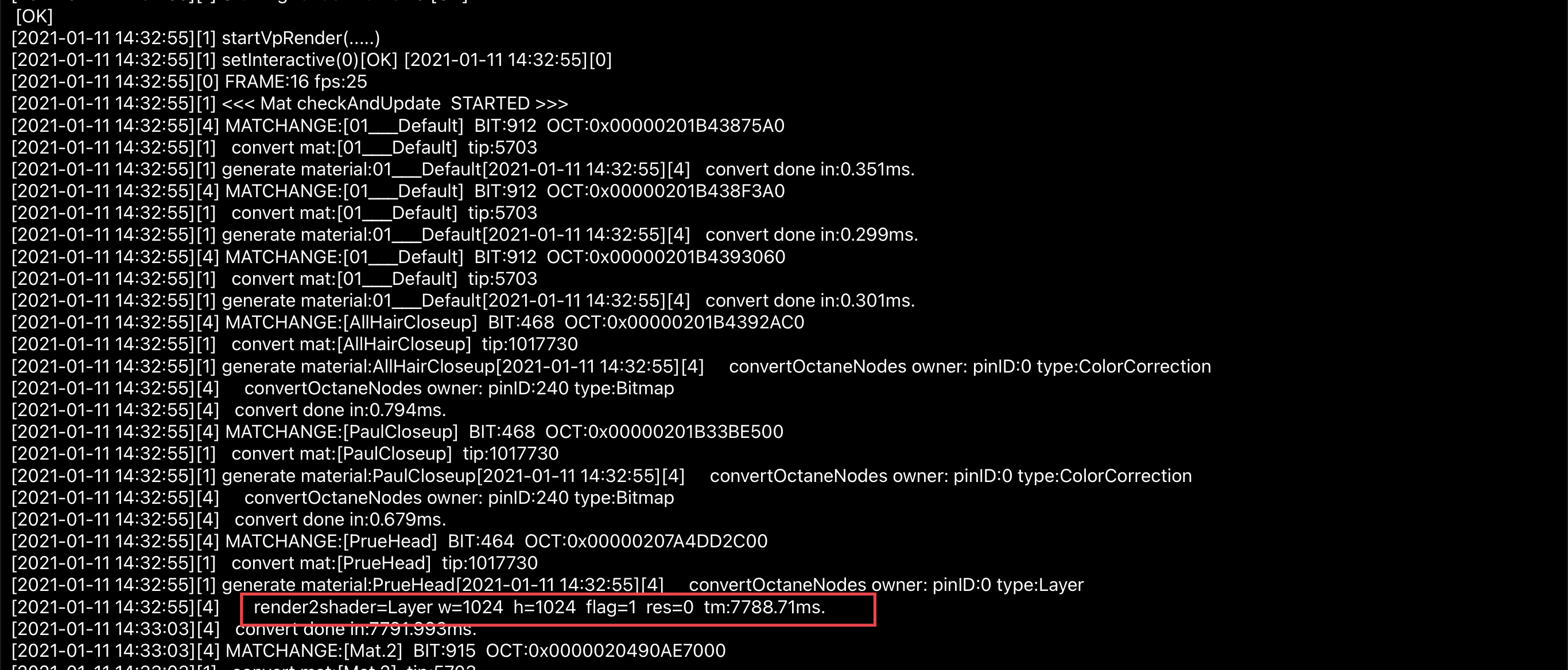

Posts: 10618
there are several c4d Layer shader in the scene, that is not supported, especially in Net render.

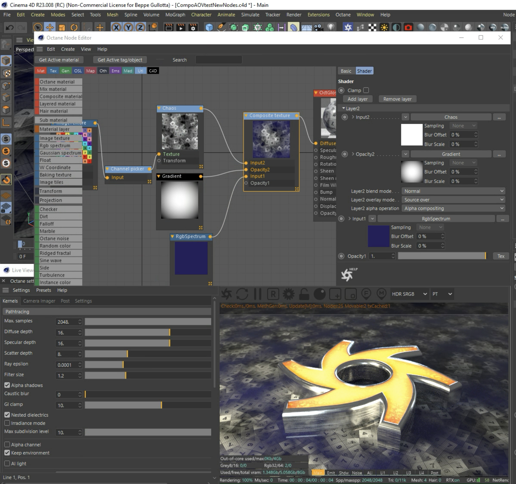

Till 2020.1.5, you can replace it with OSL color_layers.osl node that you can find in LiveDB/OTOY/Procedural Textures/Utilities category:
But since you are working with Ampere GPUs, my suggestion is to update both Workstation and Render-nodes to 2020.2-RC6.
In this way you can use the new Octane Composite Texture node to replace the c4d Layer shader.
Please avoid to use c4d Shaders in general, especially with Net render, unless they are c4d Noise or Gradient shaders, that can be automatically converted to OSL, with the proper option in Settings/C4D Shaders tab:
