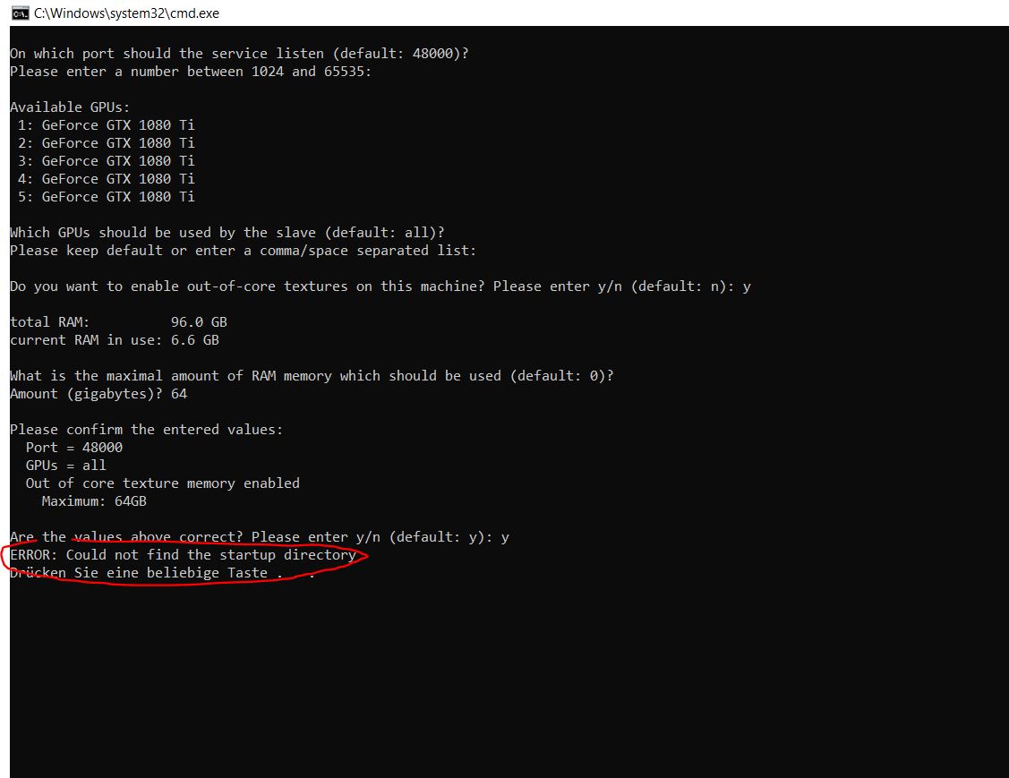

Iam trying to setup render daemon for Network Rendering and get the following error:
"ERROR: Could not find the startup directory"
What could i try to get it work?

Hey Beppe,
I tried out 3 different machines, all WIN10. On each of them, I can not run the batch "_install_daemon.bat" at folder "OctaneRenderEnterprise Slave 2020.1.5" or "_install_daemon.bat" at folder "OctaneRender Enterprise Network Render Node 2020.2". I just get the same error "ERROR: Could not find the startup directory" everythime and cannot install the daemon.
On one other WIN10-machine, I can run both of the batchfiles and istall the daemon.
Firewall and Antivirus is disabled on all machines while I try to install.
If you have any suggestions what else should be checked, please let me know.
Best regards!

Hey Tugpsx, I can confirm that it was pretty easy to get the Daemon working on on machine. But not on three others. The OS and language settings are equal on all machines. I did not edit the batch script and it installed smooth on one machine but fails to install on three others. Firewallsettings should only be relevant when it comes to communication between the the server and the nodes, but not while running the bash-script install_daemon.bat, right? Running the script as Admin did not change anything. :?
you may have to edit the batch file to properly locate and launch the application.
Could you show me what kind of changes you would suggest? I am willing to try out whatever might help.
Best regards!
