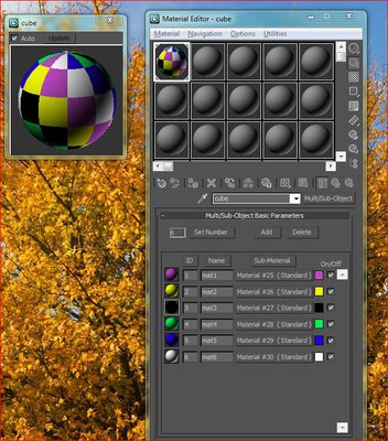

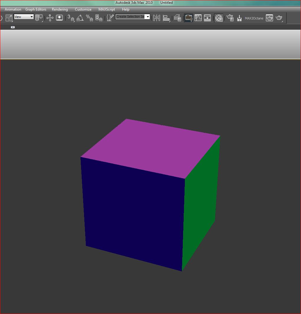

maybe this will help.Please see attached screen shots.
Make 1no Multi/subobject material in Max.Apply it to the model.(see Cube in the max screengrabs)

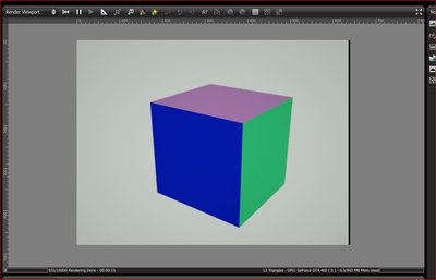

materils should stay attached when transfered into octain ( See Octain screen grab output which matches the cube in Max)

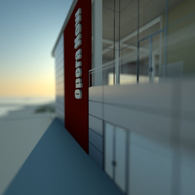

Here's what I'm working on (level adjustments and resize in Photoshop; a bit of added blur on the second one)... The goal is abstract renders to communicate design intent, not photorealism. The project is a regional opera house with a focus on contemporary performance.
