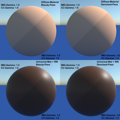

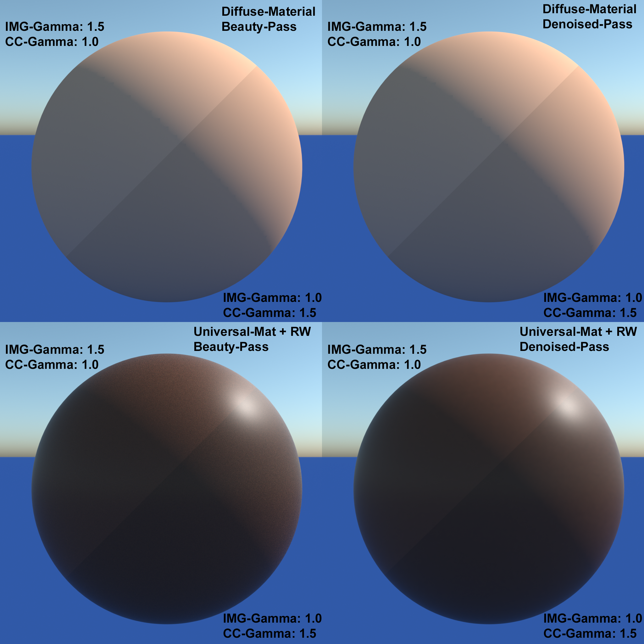

Ok, sorry for the lack of given material in the original post. I thoughed i just didn't understand something and it wouldn't be a technical issue.
Quite a few issues i experienced while testing:
Appearence is different on Diffuse too like on random walk.
(Diagonal-Comparison)
Other issues i see:
- Denoising darkens the enviroment or image as whole, didn't have the time to evaluate it No, it's fine, my mistake. :?
- Random Walk keeps being very noisy, even after many samples (for image provided i used 1000)
- Phong-Artifacts / Shadow-Artifacts
Build 2020.2 RC6
Test-File attached
Kind regards
