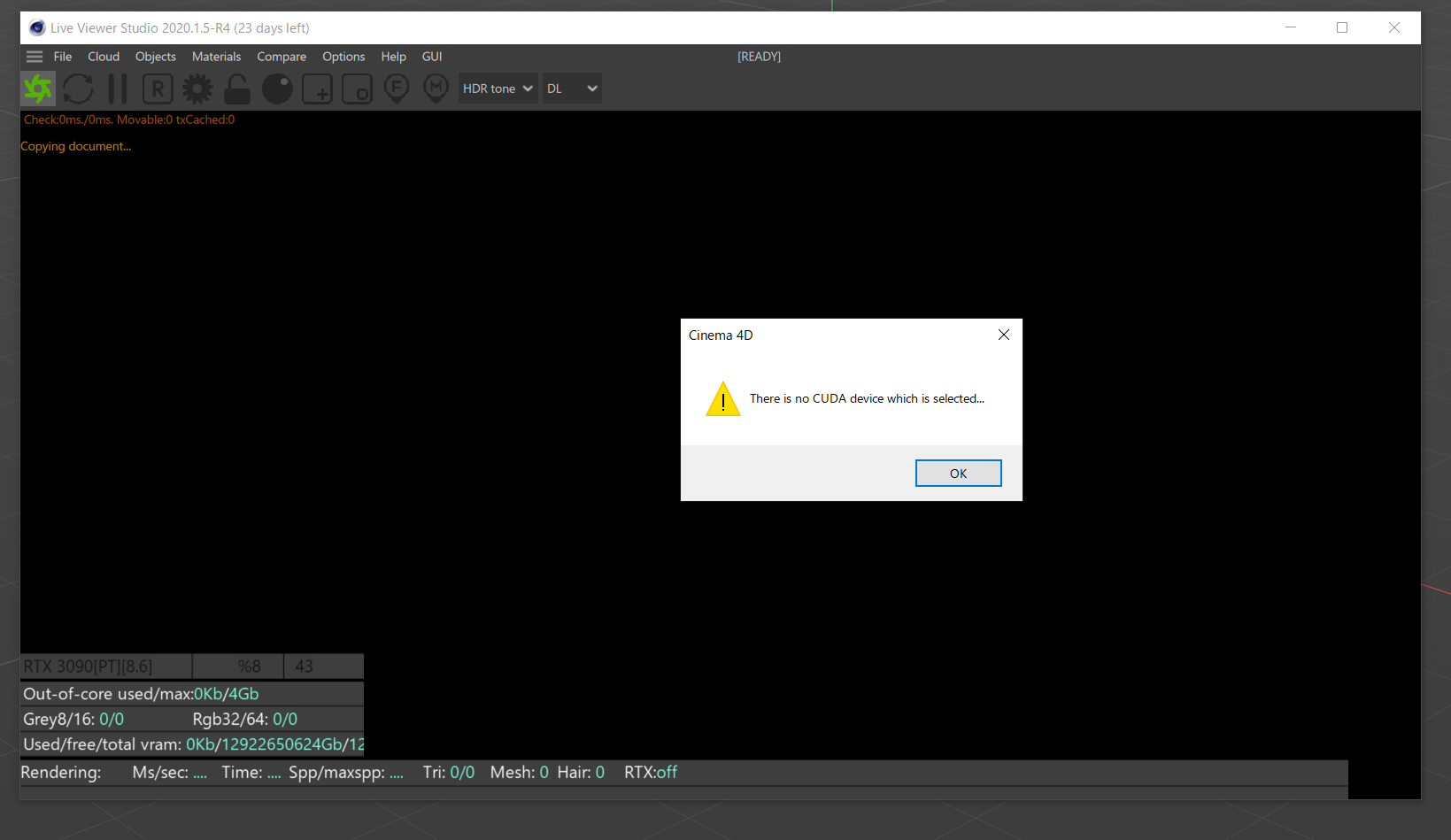

HELP!there's no cuda
meikonishi
Posts: 5
Joined: Thu Sep 28, 2017 4:03 am
I bought 3090 RTX didn't work octane.
Studio driver installed.(and clean install)
what's other things??
Cinema4d R22 with octane 2020.1.5-R4
Cinema4d R20 with octane V4.05
Posts: 10598
Please have a look at here:
viewtopic.php?f=25&t=74226&p=394606#p394606
There is also a new c4doctane version 2020.2-RC6, with full RTX 30X0 Ampere GPUs support..
You can find the download links at the following link, please download and install based on your license type and operating system:
viewtopic.php?f=85&t=76633
ciao Beppe
