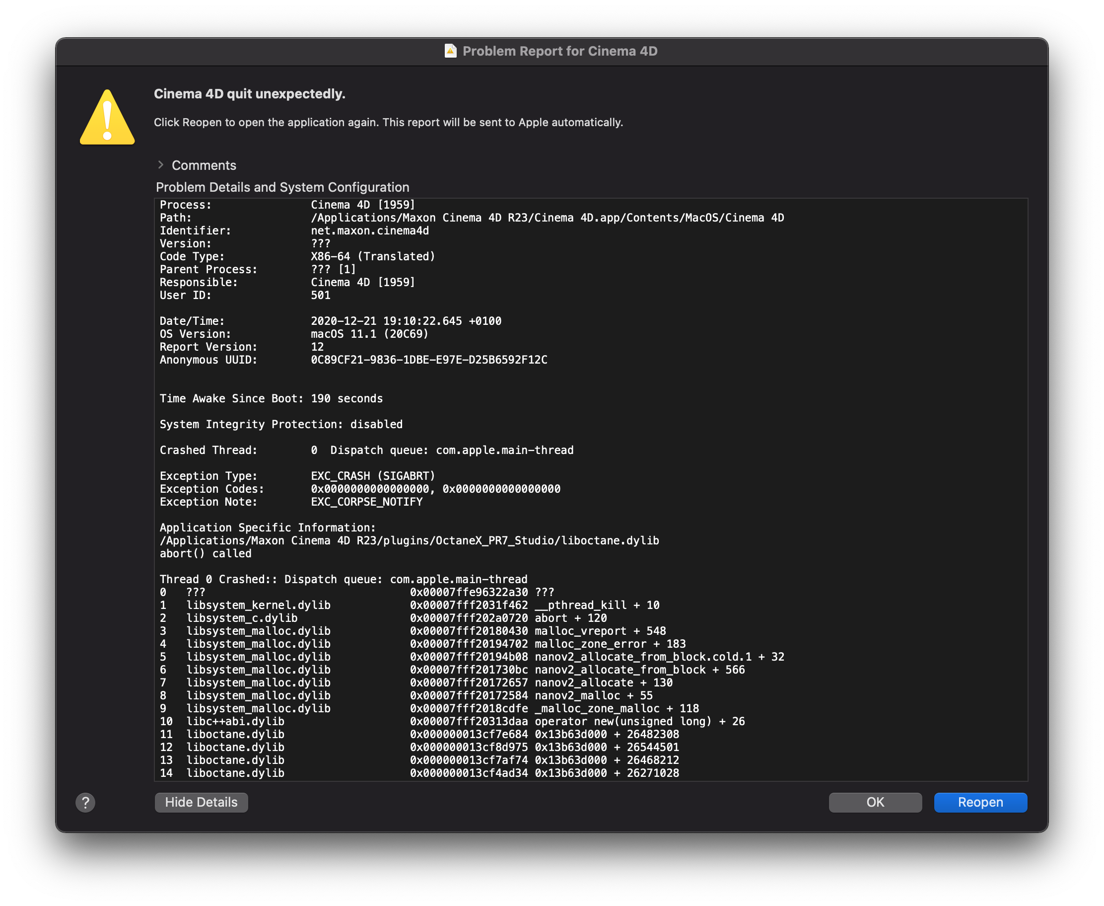

Hi I've installed PR7 Studio plugin on my M1 Mac, and Cinema now just crashes. I've enabled the app to run via Rosetta, and I've allowed apps to run from "anywhere". I have even disabled SIP (system integrity protection). I have deleted the other lib files which are not for r23. I've placed the plugin-folder in /Applications/Maxon Cinema 4D R23/plugins

Janmansilver wrote:Hi I've installed PR7 Studio plugin on my M1 Mac, and Cinema now just crashes. I've enabled the app to run via Rosetta, and I've allowed apps to run from "anywhere". I have even disabled SIP (system integrity protection). I have deleted the other lib files which are not for r23. I've placed the plugin-folder in /Applications/Maxon Cinema 4D R23/plugins
have you download it from this link?
viewtopic.php?f=85&t=76547
And deleted other plugin dlls which for R21/S22?
Yes, exactly. I've used your link and deleted the unnecessary dlls.

Please also test blender or (if you have access) standalone?
