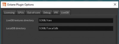

I try to copy my library of .orbx materials on the localDB path (C:\Users\USERNAME\AppData\Roaming\OctaneRender\localDb\), but I can't see it inside houdini.
Inside the "Octane Render standalone" I can see theme and they work.
It seems that the path of the "LocalDB" inside houdini is another.
Any suggestions about it?

You can configure the localdb directory in the plugin options panel.

Thank you Juanjo!
