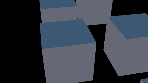

hi, there is a strange wobble / jitter / shaking happening when rendering a panning a camera in Octane:

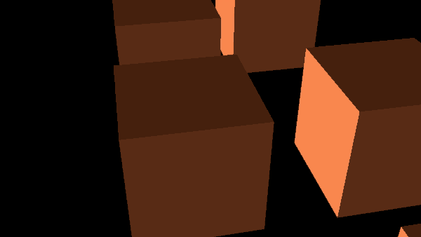

This doesn't happen in Standard render:
I had a search and found other people are having similar problems: viewtopic.php?f=30&t=55745#p285588, but couldn't find a solution that worked for me. The Ray Epsilon is 0.01, so not sure that has anything to do with it. My Camera focus distance isn't negative either, so run out of ideas.

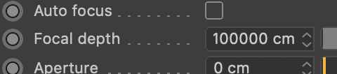

In case anyone is wondering, increasing the Focal Depth seemed to have fixed it:
