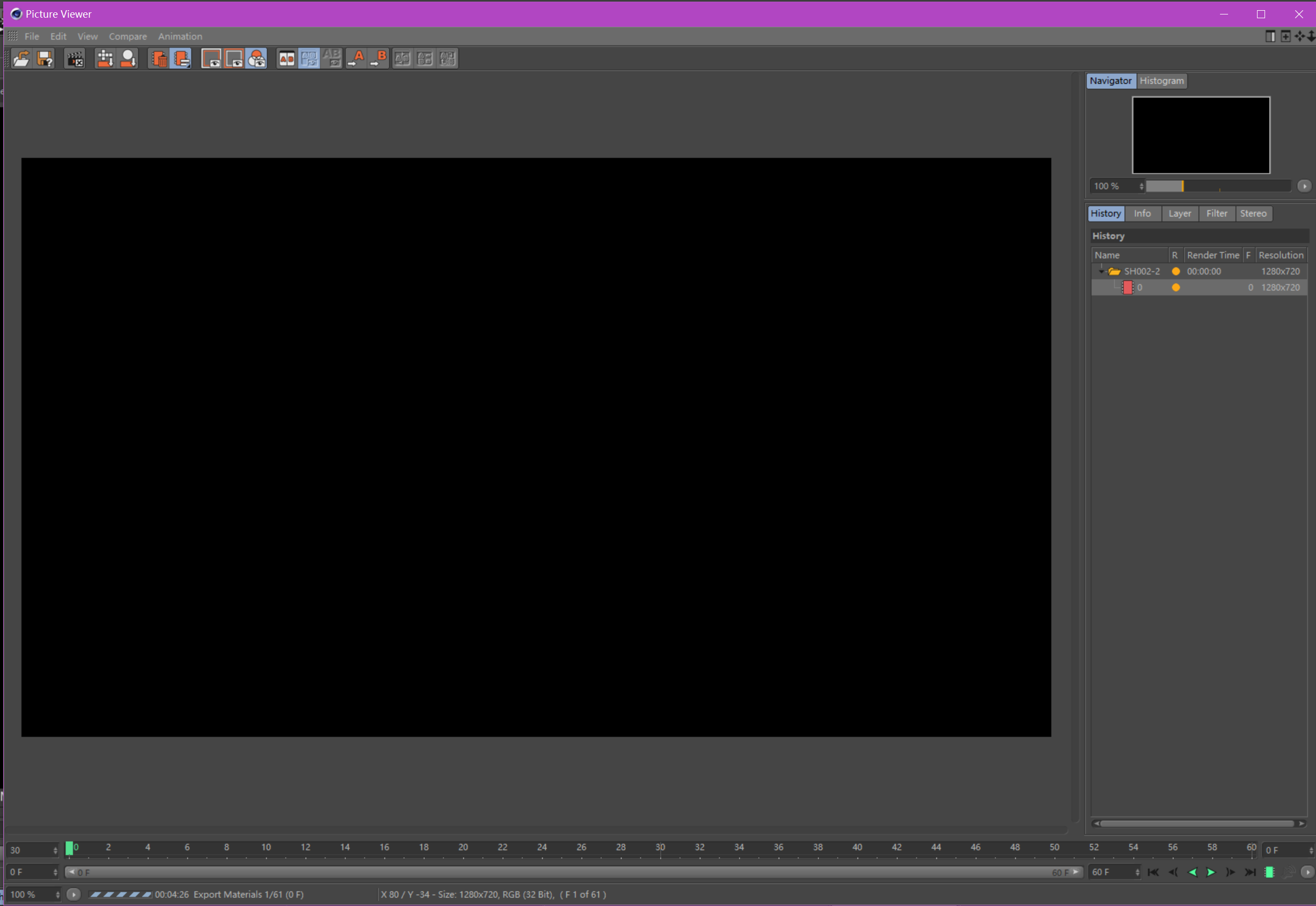

I have the exact same problem on a scene (deadline tomorrow).
Config: Win 10Pro / C4D R23.008 / Octane 20.1.5-R4 / Nvidia driver 456.38
Intel Core i7 9800X / 96gb / RTX3090
Live Viewer works without a problem.
After launching the Picture Viewer the process is stuck at "exporting materials".
Scene is an architectural project. I checked all the materials one by one. Network rendering is off. Denoiser is off at camera settings, render settings and octane settings.
I tried to copy the scene to a new file, to no avail. There are no subdivided surfaces. File is on a local SSD drive. I also tried to save project with assets to a new location. Still the same problem.
Again, live viewer works.
The program is crashing even if I just try to launch the texture manager (it goes "Not responding" in task manager, but the CPU usage changes). I tried about 30 different combinations (deleting some elements from the file), but I couldn't pinpoint the source of the problem. If I delete everything, just keep a grass plane and the sun, it works. It works even if I LEAVE the materials in the file.

please, open the scene, then go to c4doctane Settings/Other tab, and, at the bottom of the panel, enable all the Log option checkboxes.
Then, load the scene in Live View, then in Picture Viewer until crash, then reopen c4d, navigate to c4doctane Settings/Other tab, press the Generate log report button, and share the octanelog_report.zip file, thanks.

Here you go. I have two files, because it seems to me the c4doctanelog.txt resets when I reopen C4D, so I'm not sure if all the logs are generated correctly.
I made this second log file by pressing the generate log report when the picture viewer is stuck at the exporting materials phase. That txt file is much bigger, should have more info.
