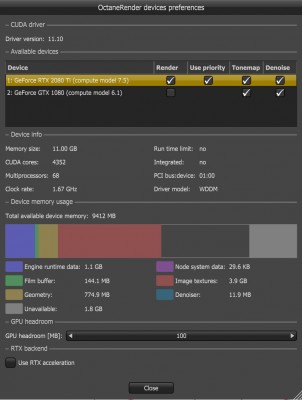

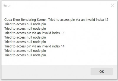

I`ve been working on this model since 1 year in the design process of this house.
Currently I was working on the lighting concept and therefor implementing several lights.
Suddenly I get
“Cuda Error Loading Scene : Tried to access pin via an invalid index 19
Tried to access null node pin”
Invalid index 19 – 28
Or
It can´t load a certain element and the program crashes.
Especially the orbx blocks don´t work. I have a light emitting VDB in the scene and a pretty big fur carpet, but even if I leave them off, the render doesn’t show the other orbx like trees.
A solution would be very much appreciated. I`m fighting with this already far too long.
A few weeks ago, I updated the NVidia driver. Could this be the cause?
I have GeForce Experience installed and updated to Nvidia studio driver 456.38.
Windows 10 64bit, 1 x GeForce GTX 1080, 1 x GeForce RTX 2080 Ti, 64 GB Ram, i7-6900K 8 Core CPU

Hi - this is almost identical to the another reported problem here in the forum, and I have an idea what is causing the issue.. I am working on a solution now.
Paul
face_off
Posts: 15755
Location: Adelaide, Australia
I have updated the installers at the top of this thread with:
2020.1.5.123
- Fixed crash introduced in release 20201.5.122 when rendering block instances
Paul
Blum-Architekten
Posts: 5
Joined: Mon Apr 20, 2020 10:29 am
Thanks a lot Paul!
The new release solved the problem.
