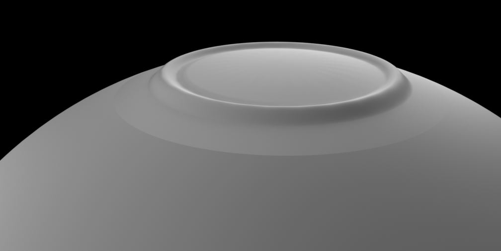

wallace wrote: So I have looked into this and found that this is caused by some backwards compatibility with how the Octane BRDF has to work while there is only diffuse and specular reflection, and this is not really fixable as it would affect the things we are trying to be backwards compatible with work (this would impact the consistency between glossy material with Octane BRDF and universal material with diffuse and specular reflection with Octane BRDF).
Would it work for you if you use other BRDF models instead? This restriction is only posed upon the default Octane BRDF.
If I crank transmission to 1 and use Beckmann I can still see a difference between the materials when playing with roughness. GGX seems to be the only one working so I can use that.

Zay wrote: If I crank transmission to 1 and use Beckmann I can still see a difference between the materials when playing with roughness. GGX seems to be the only one working so I can use that.
Beckmann:
This should not happen on Beckmann, I would expect it to behave more or less similar to GGX, I will look into it.
Thanks.
