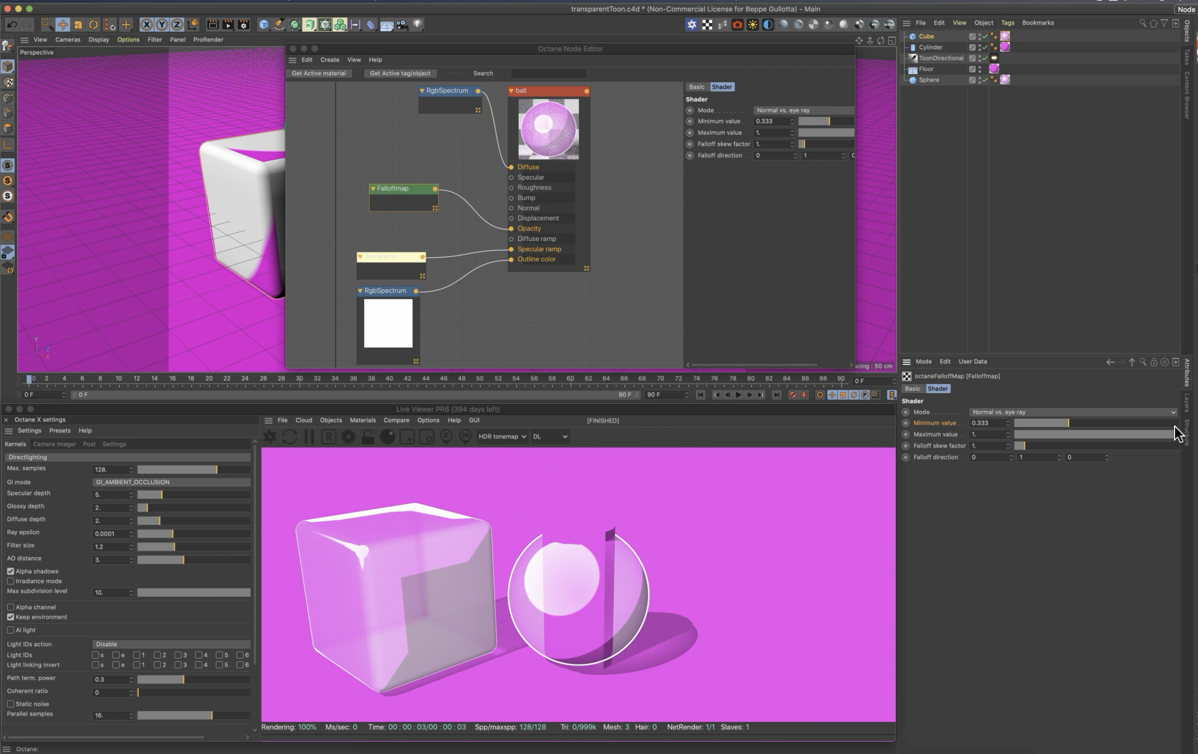

Hi Beppe,
I really appreciate the help, thank you. This seems closer. In trying to replicate your setup, the Falloff is affecting the opacity of the Specular which is undesired. It appears to be the same for your Specular, which is semi-transparent. It's creating a gradient in the material's Diffuse which I do not want: I need it to be transparent (or very close). Also, this setup has the Diffuse being the same color as the background, which will not work with my project where the glass will be in front of different colors. I have attached my scene file in case I am doing something incorrectly in replicating your setup. Is it possible for the Specular to be fully opaque and the Diffuse close to fully transparent?
Some ideas:
Some ideas:
- Are there any Octane/OSL shaders that will react to Toon lights that can be quantized (or use a Gradient with Constant knots) and added to the Opacity channel?
- How is the OSL[util] "Raytype" used and could it be used to isolate the specular?
- Does the ToonRamp node work with any other node besides the Toon Material?
- Perhaps this possible with a non-Toon material?
