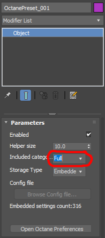

Octane Preset Parameters:
Enabled : Enable preset. Only one preset can be enabled at a time. If multiple preset exist in the scene, the one previously enabled will be disabled.
Helper size: Helper size in the viewport.
Included categories: Categories of settings to store. Select 'MAIN' for all scene related settings, or only a subset of settings. Note that Categories can only be changed when the preset is Enabled.
Storage Type: Variables can be stored in an external config file or embedded in this object. External file can be shared by multiple scenes, and is instantly saved.
Config file: When Storage type is set to External file, select a file to store the settings. Use context menu for more options..

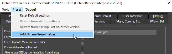

When sending us a sample scene with an issue, please add an Octane preset object. That allows us to investigate the issue with your exact settings.
-Open your scene
-Open Octane Preferences window
-Choose Add Octane Preset helper from the Preset menu. This should select the new object.
Select Modify in the object panel, to access the object parameters.
Change the Included categories to 'Full' -Save your scene
