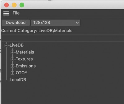

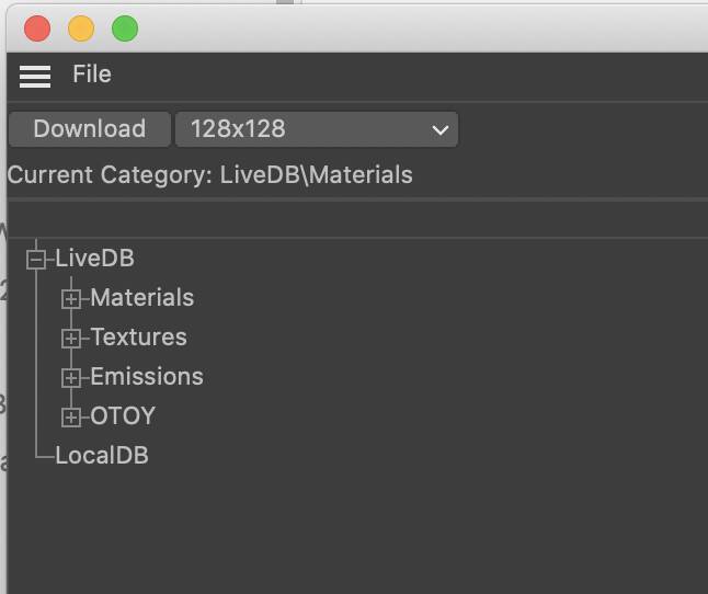

hi, I don't seem to be able to down load materials from the LiveDB database:
I'm using R22 with PR3 on a Mac running Catalina
Posts: 10654
everything is working as expected here with c4doctaneX PR3.
Please, follow these steps:

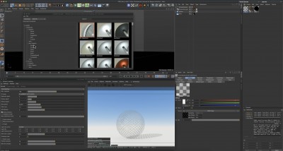

  • Open an already saved scene, in this way the plugin can save the material textures inside the proper tex folder, in the directory of the scene
  • Load the LiveDB panel, click on the + symbol to expand the macro categories, and select one of the desired category
  • Select one of the material preview and press the Download button, to correctly save the LiveDB material and textures in the scene
