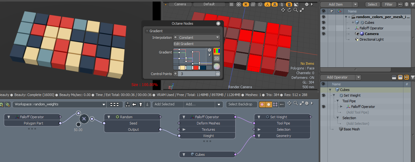

The Octane core doesnt support anything like this (yet), so you have to use workarounds.
One way could be to use weight maps, and manually/procedurally/script the assignment of different weights per mesh "island". Then use the "greyscale vertex attribute" node as an input to a gradient for your colors.

I have attached an example scene of 1 possible way to assign the random weight map values with meshops. It uses a "falloff operator" which has a confusingly named "Polygon Parts" output, which is actually MESH ISLANDS!
I then used Octanes greyscale vertex attribute node to get the weight map values and input to a gradient for the colors.
EDIT: If this is slow on heavy meshes like trees, you could just FREEZE the meshop, which will apply the weights to the mesh permanently.

Someone posted some questions about this setup on the modo forums:
https://community.foundry.com/discuss/t ... nent-level
Regarding the falloff operator:
Its just a single falloff split into 2 to make the schematic more readable.
In modo, you can add the "Polygon Part" channel by right clicking the falloff operator > add channel > Polygon Part.
You can then right click the Polygon part channel on the node > separate channel

You could do a separate render, plugging the greyscale vertex attribute node into the diffuse channel of a material, then enable render passes > info passes > material diffuse filter.

thanks - did something similar and it seems to work really well.
it also works on multiple items using the same name for the weight map so only needs one additional render with all the items plugged into the variation set up. easy enough to just unplug them when done.
