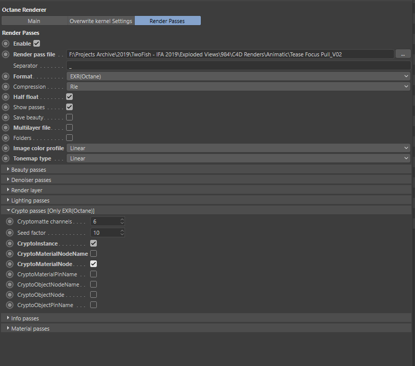

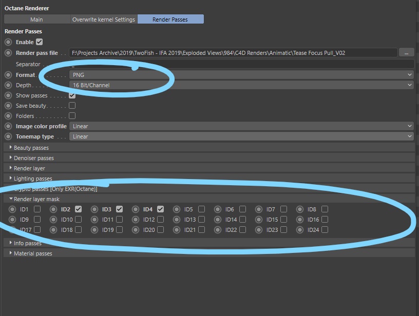

Hi Beppe, thanks a lot for your reply and effort. Sorry if i was unclear but i'm looking for a way to render cryptomattes plus Layer masks (Seperate B&W image per Layer ID), see image. The problem is that when i select "EXR(Octane)" it enables the cryptomattes option but hides the "Render layer mask" section, see image attached. When i switch back to "EXR", it re-enables the Render layer mask ID's but you're not able to render cryptomattes. Is there a way to get both?bepeg4d wrote:Yes sure, why not?

Not sure how to use the "Render layer mask" pass from the "Info passes" section but it looks like it combines all Layer ID's?
So, we are going back to my first answer here:
viewtopic.php?f=30&t=76101#p391414
Render layer masks are not calculated with Octane engine, but with c4d internal render engine, so are obsolete and incorrect...I don’t know another way to explain this
I think that it is better for you to find out why Cryptomatte is slow in AE in an AE forum or similar, since you are the first one to report this, and it is not directly related to Octane
ciao Beppe
