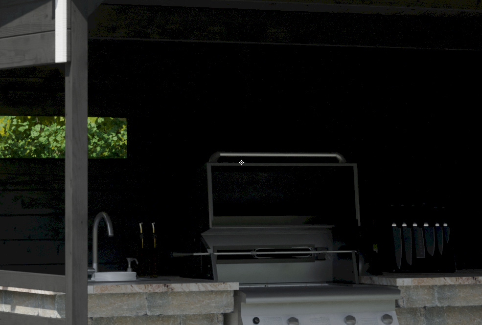

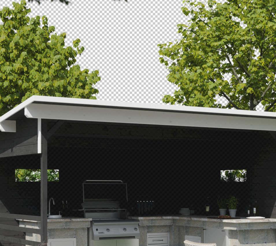

I have strange color and transparency bug with this version. Worked on an old scene and changed the wooden material. A few months ago all was nice with the scene.
Now with current version the PNG saves some kind of transparency to the wood. It's just a glossy material.
I also tried TIFF but the black is completely washed with hard jagged edges.
What's going on here?
EDIT: When I press "port to max framebuffer" and save from there to PNG it looks better. But the strange hard shadows are still there.
EDIT2: I figured out the bug. It's the denoiser. When I disable denoising I can press the "save image" button and it saves to PNG fine.
If the devs need the scene I can sent them to you.

mbetke wrote:I have strange color and transparency bug with this version. Worked on an old scene and changed the wooden material. A few months ago all was nice with the scene.
Hi mbetke, I have not issue using denoiser. Have you this issue using old scene only?
Could you tell me, opening an old scene, checking the Octane version in Render Setup > Tools > "Current scene" panel
Regards
Paride

Its 8010500 - 1019 - Max version:2021
Seems it is the current version. I saved my old scene of course after I made the modifications to the old scene. Just had to change the color of the shed for my client.
