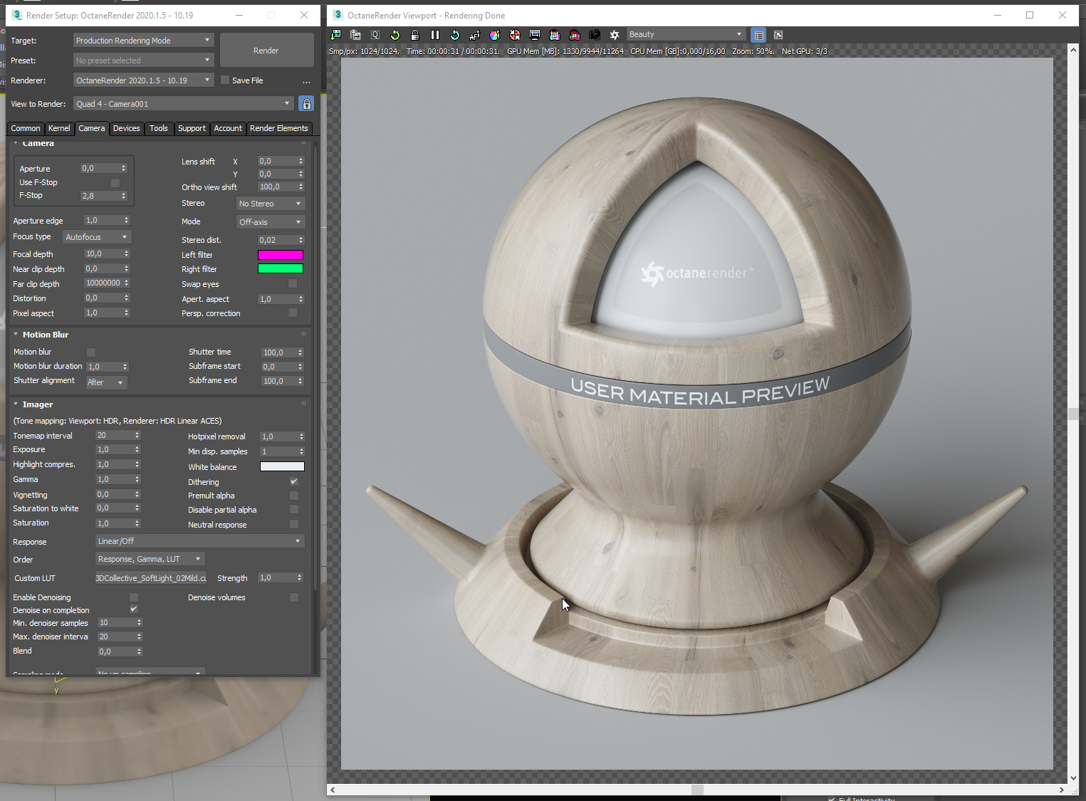

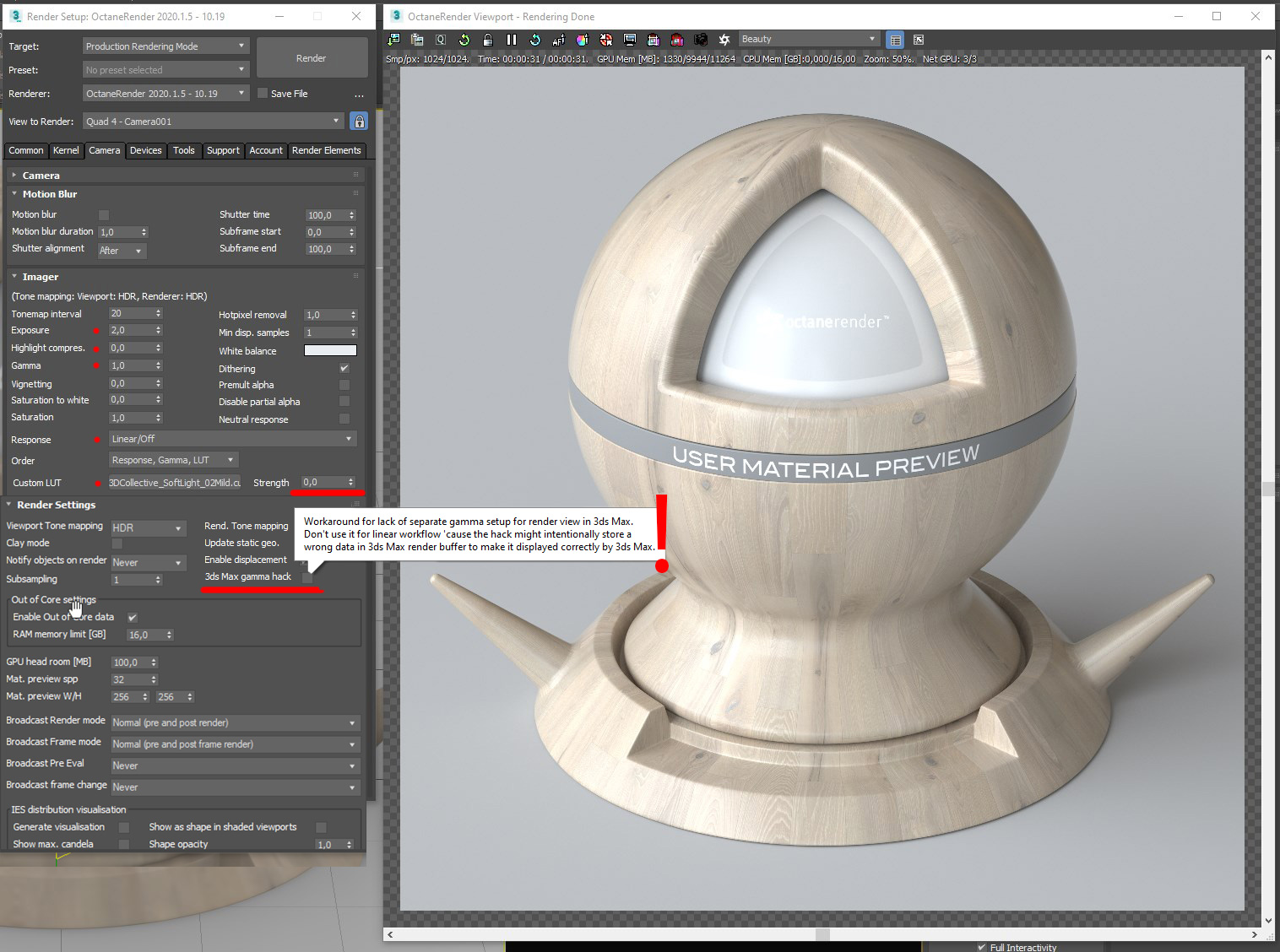

I saw different explanations for the theme, so I wanted to see once and for all if I understood that right.
My Settings for Linear Workflow in octane;
1. Imager > Gamma: I don't quite understand why I should leave 1, because if everything is in Linear it should appear darker. ( like in Vray, you have the sRGB in the viewport to use )
2. After that, I just use Highlight Compression, to make it more visually pleasing and use LUT to give it a photographic look.
3. Otoy removed the option to deativate the Imager, now I can no longer save the images directly into Framebuffer in 32 Bits, Octane clamp the images.
