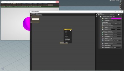

is there a way to export octane materials to localBD or directly to ORBX like in C4D-> right click on material ->save?
many thanks for any hints
best
jn
juanjgon
Posts: 8867
Location: Spain
In Houdini, you can use ALT+Left click over the IPR window to open the Octane native node editor including the material node graph. From it, right-clicking over the material node, you can export the material.
