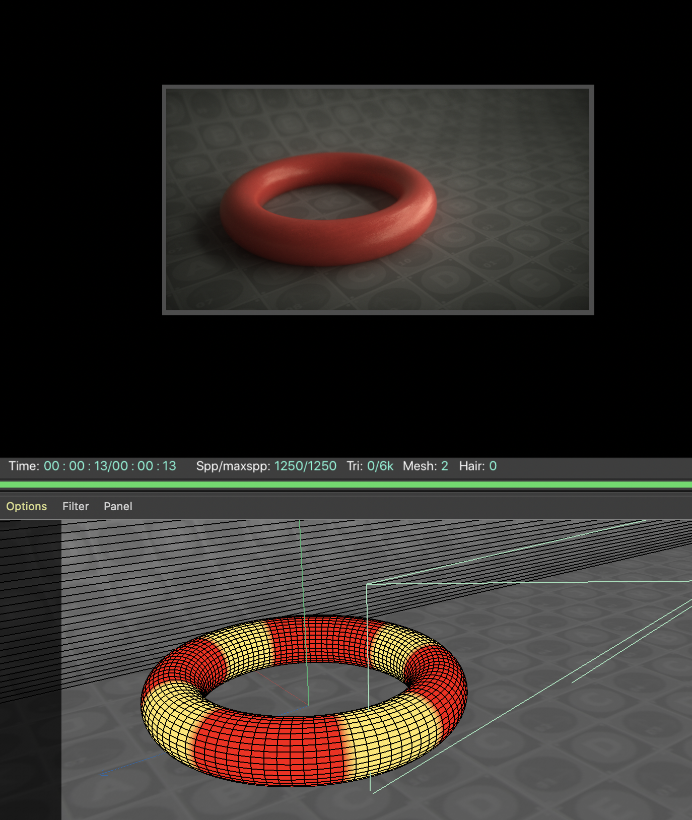

Is there any update on vertex maps in octaneX for c4d? Not working in PR2 also

jschoenith wrote:Is there any update on vertex maps in octaneX for c4d? Not working in PR2 also
It will work when "OSL" support comes
