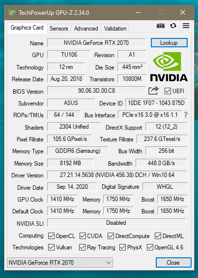

What makes the difference, is not the C4D version, but a correct installation of stable Nvidia driver.
Please, download and run GPU-Z:
https://www.techpowerup.com/gpuz/
And share a screenshot from the Graphics Card tabs, for all the available GPUs, thanks.
ciao Beppe

Well, Bepe, i'll record some video and drop it here asap. LEt's first upload GPU-z screenshot:
So, i suppose that the problem is c4d-related

So, Bepe, i did everythingg exactly as you asked me. Any thoughts?bepeg4d wrote:Deactivating basically means to close C4D to deactivate the licenses, or they will be blocked after Win 10 update, and you will have to visit your OctaneLive page to unlock them, or contact [email protected] if you have already finished the unlocks.
ciao Beppe
you are not using the latest version, please upgrade to 2020.1.5-R3, and report back, thanks.
