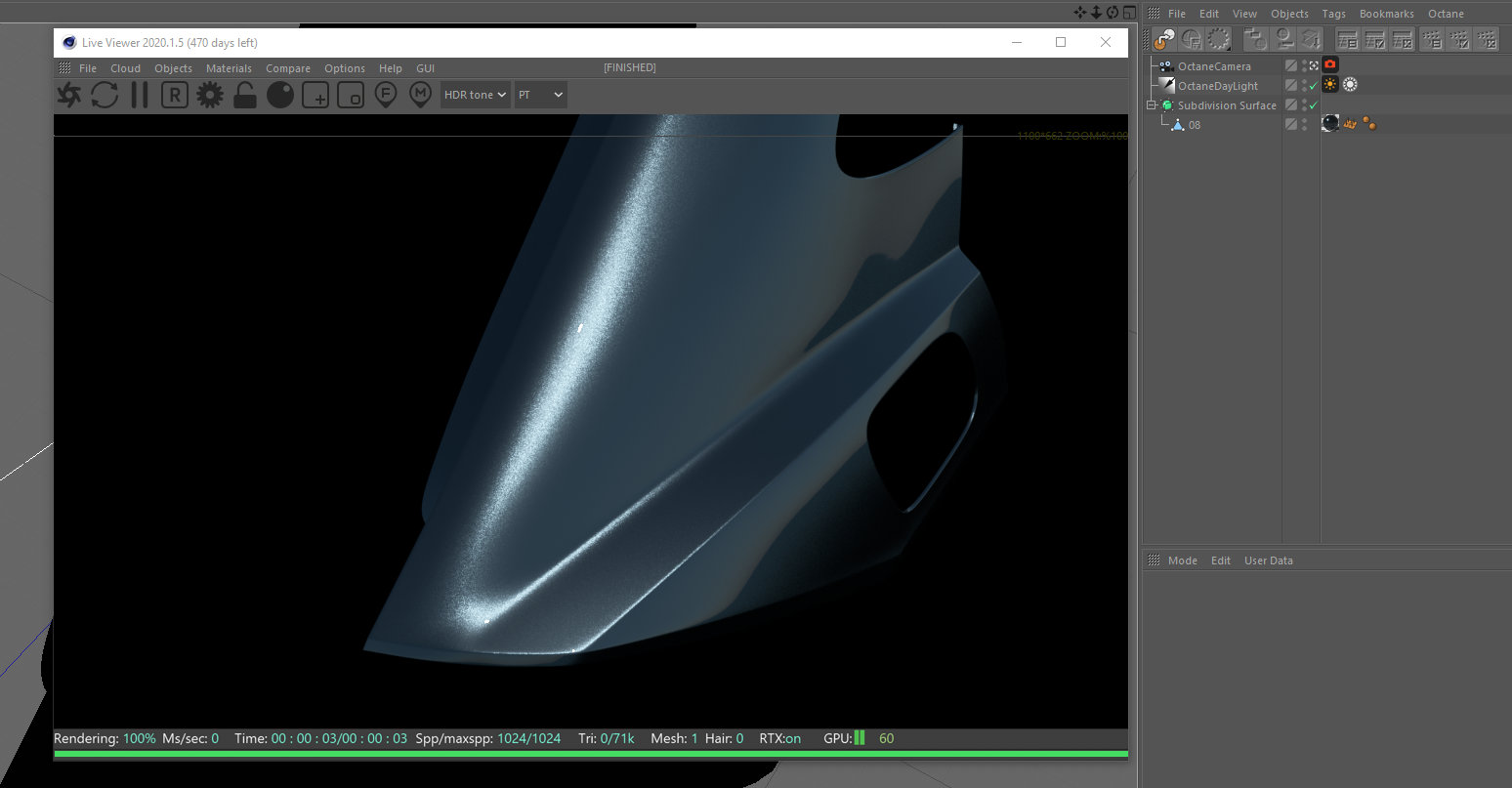

Thanks for the response.
While trying to create a test setup to show you the issue. I think I may have figured out what is happening.
Here is the triplanar setup in the node editor:
If I render this, I get harsh fall off where there are UV seams:
This only really becomes obvious when the "Flake Normal Orientation" is dialled to higher values. I do find it necessary to dial this value to around 0.7 - 0.95 to get the look I need.
By accident though I think I fixed it by deleting my UV tag from the polygon object.
See the results below:
For some reason the object needs to have no UVs for the triplanar to work properly. I'll do some more tests on my actually production car and see if the fix is really this simple.
