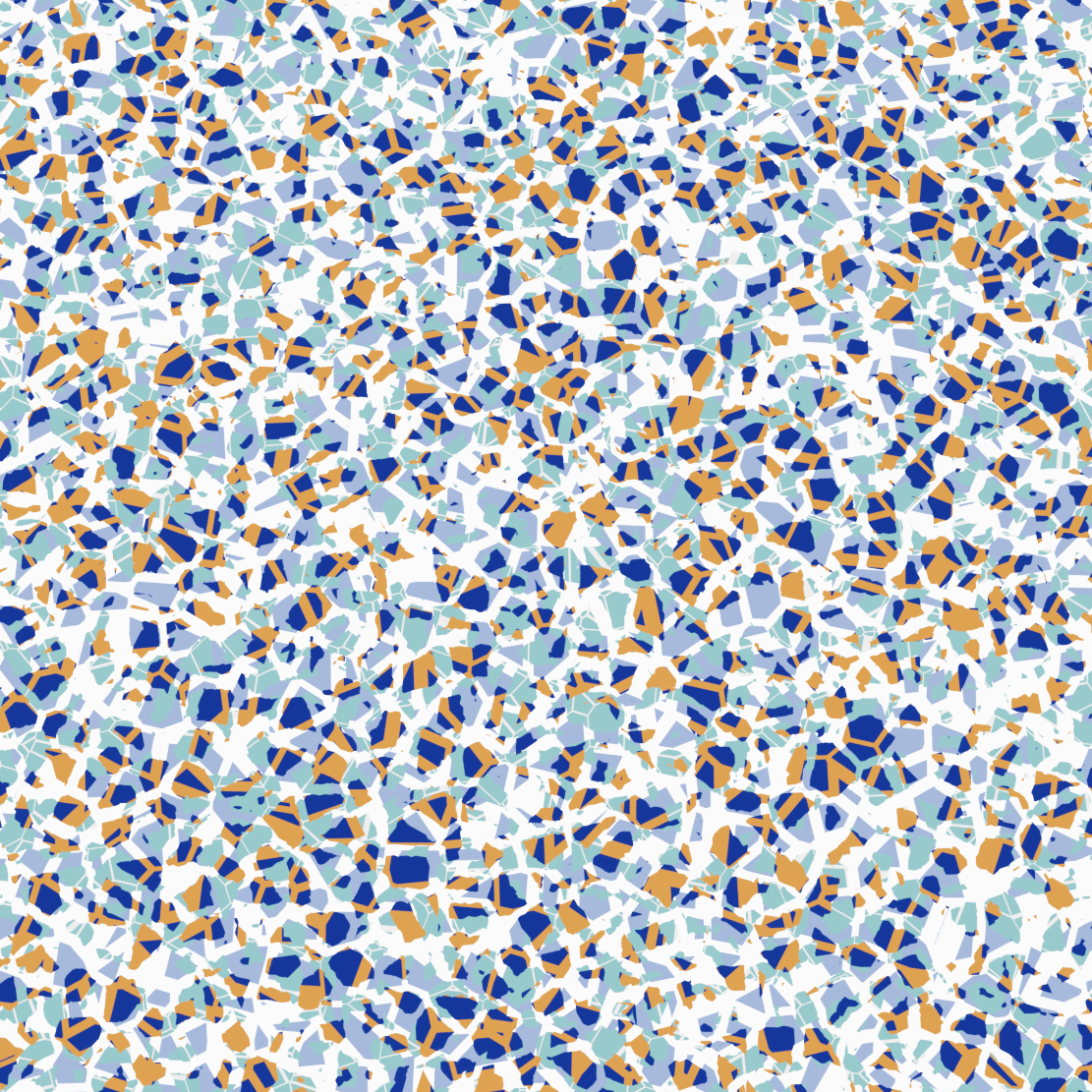

Hi there i am fairly new to octane and the octane forums (please let me know if i have posted this in the wrong spot) and i am after some advice for a material.
I am trying to make a material that resembles terrazzo that i can scale and modify with different image textures.
The octane noise with a xyz uvw projection gives a great effect but is there a way to add image textures to each section that this generates? See example on the right.
I have tried to do this using a composite material with different image textures and masking out a seamless patterns in the composite layers. Although this got the right look the mapping did not work as it was not wrapping around objects or seamless. see example on the left.
Any feedback or direction would be greatly appreciated as i have hit a wall and would love some help.
See working files here if you need them
https://bit.ly/3ieoRgs
thanks
Keenan

HI Bepe Thank you for the response :)
I will be sure to post this in another area next time.
I have tried using different projections but doesn't seem to work.
How would i go about doing a procedural noise generation with four different textures?
I can make a simple noise with chips to generate the terrazzo effect but how would i apply a unique texture to each segment?
I have attached a node screenshot for the composite material with image textures using the seamless pattern to mask and then image texture to apply a unique texture.. But i would love to make it procedural with a noise chips generator that splits into 4 different materials.
Any advise would be amazing.
Keenan

Hi Beppe
Thats correct, however if you do it this way the noise chips texture over laps each other rather than having an offset around each chip like the example?
Is there a way to apply a random colour or something to these chips?
Thanks.
Keenan

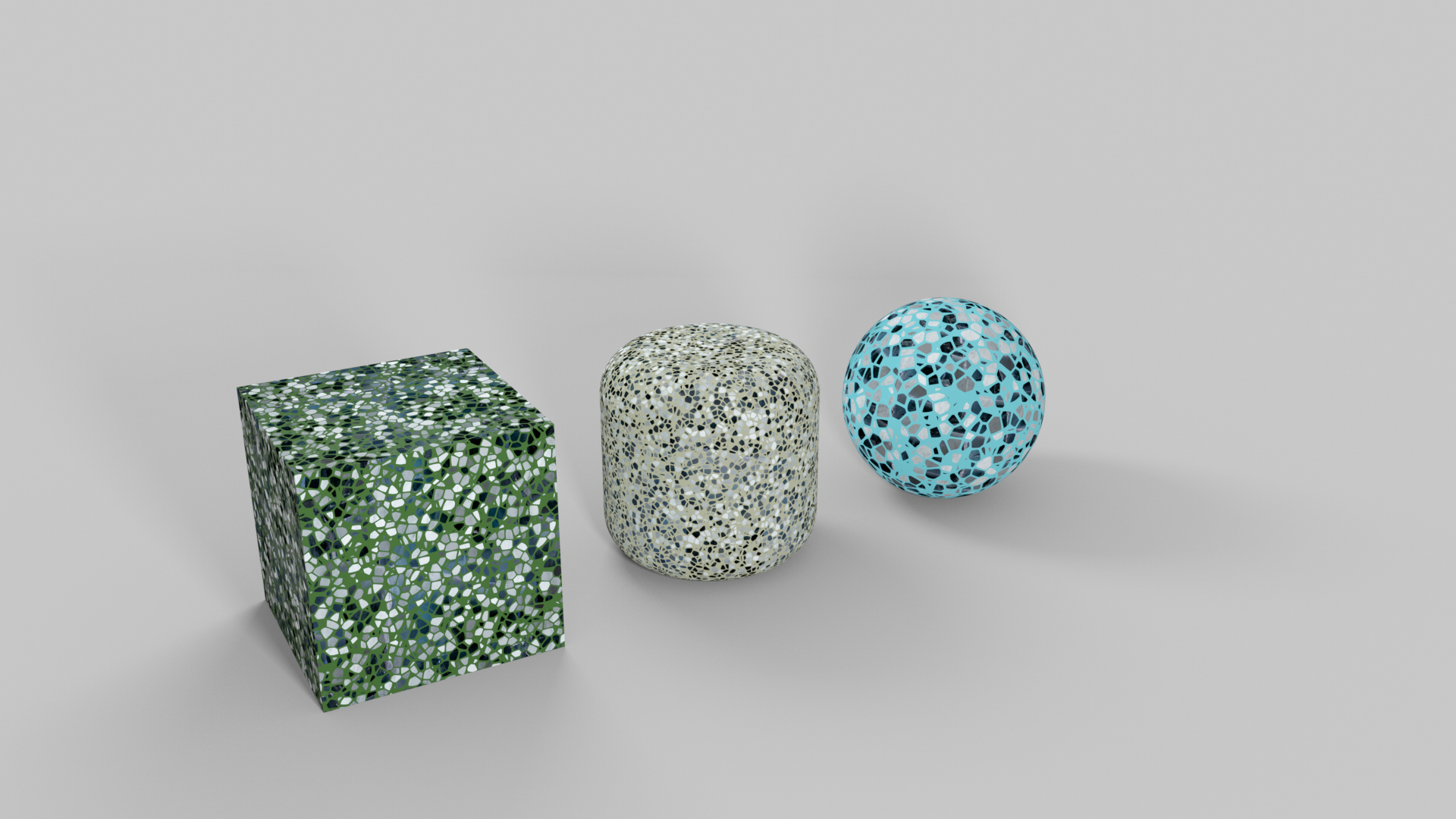

Posts: 10619
Hi Keenan,
please have a look at this other simple setup made with a Cell Voronoi piped in an Octane Gradient to give to the tiles a different color, and a Voronoi 3 for generating the black border:
VoronoiPavement.c4d.zip
(96.76 KiB) Downloaded 319 times
ciao Beppe

keenanl
Posts: 4
Joined: Tue Sep 08, 2020 4:30 am
Sorry for the delay
Wow thank you so much Beppe
I didn't even think of using c4d noise.
From that I have achieved a good result using the advance gradient, see below.
Thanks again you're a wizard :)
