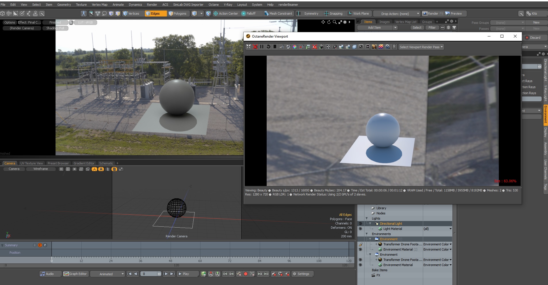

Basically having an Environment with an Image that is projected through a camera (render camera) is important for matching the shadows, shaders etc.....
I have attached a scene that is using an Physical Sun, plane and sphere. I have 2 Modo environment textures.
The first Environment is using a spherical projection and is contributing to the lighting.
The second Environment is using the camera to project the image (this is only for the purpose for matching shadows, shaders..etc..) and not contributing to reflections or lighting.
Octane Modo is not able to use the camera for the projection. Here is a screenshot and the example scene
Modo 14.1.v1 and Modo Plugin Enterprise 2020.1.4.162

Hi
There is probably a way to implement this by feeding the camera rotation matrix into the Environment Image transform using the schematic (and I think I have seen a user post the layout for this), however the intended usage of the Front Projection "Projection Type" is for projecting an Image onto geometry. So in your situation:
1) Add a large plane as the background in your scene
2) Add a Shader Tree mask for your large plane mesh, and load your background image into the mask as the Diffuse Color
3) For the image Texture Location for the image in 2), set the Projection Type to "Front Projection" and the Projection Camera to "Camera"
Now when you render, whenever the camera is moved, the plugin will re-calculate the image transformation on the plane relative to the camera.
I hope that helps.
