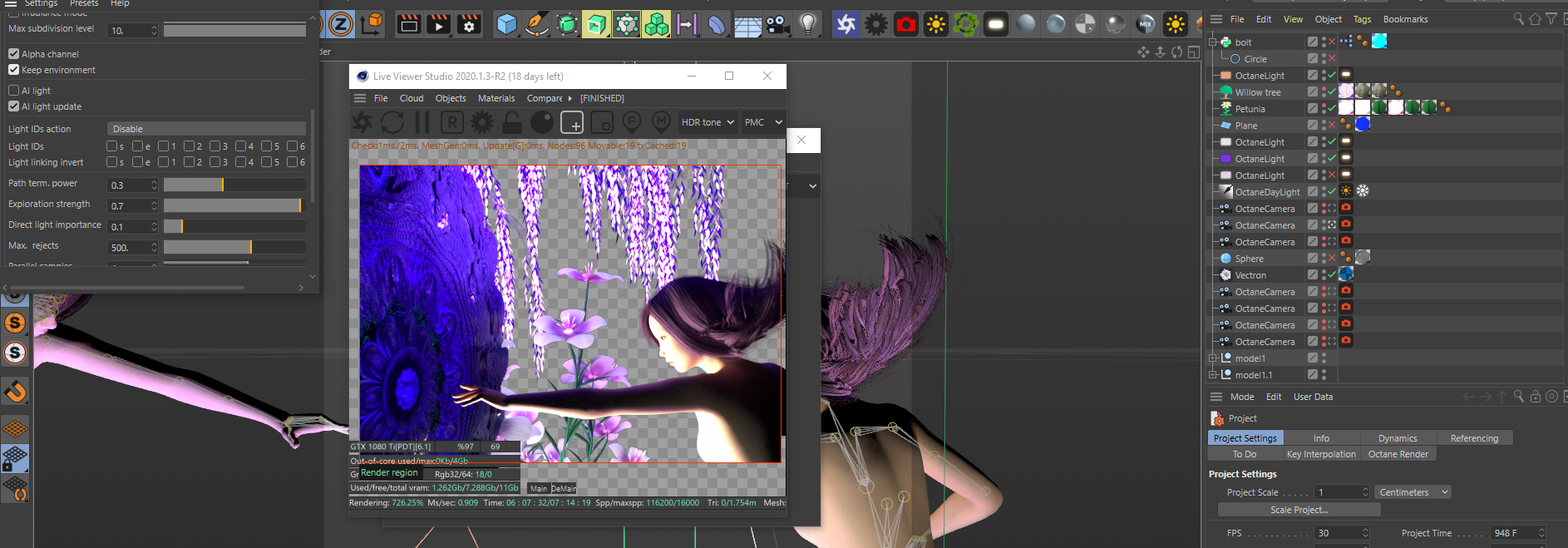

I am trying to separate out the foreground from the background make the background transparent but I am having a hard time keeping the reflections. I want to render the vectron and the girl only. I want the vectron, which has a specular material, to keep the emmission reflections caused by the emmissive tree and flowers; however, i do not want to have the actual tree and flowers in the layer. Could someone please help or point me in the right directions. Thanks in advance.

have you tried to add an Octane Object tag to flowers and tree, and disable the Visible to Camera option?

hello, I havent tried that at all. Thank you, I will do that now!
