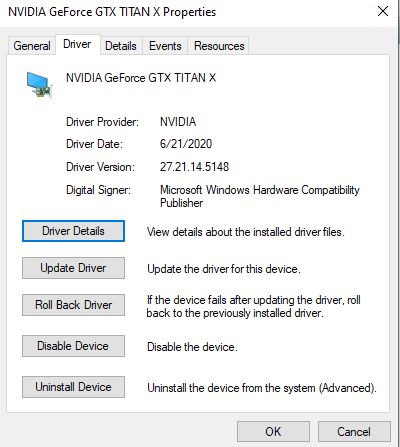

though gtx titan x is not listed in the suported list, it seems 451.48 studio is still working for it.
download the studio driver from the titan's entry, it is different from the Geforce entry.
(the studio driver of 451.48 is 536.19MB, slightly bigger than the game ready driver, so I am sure I am using the studio one)
