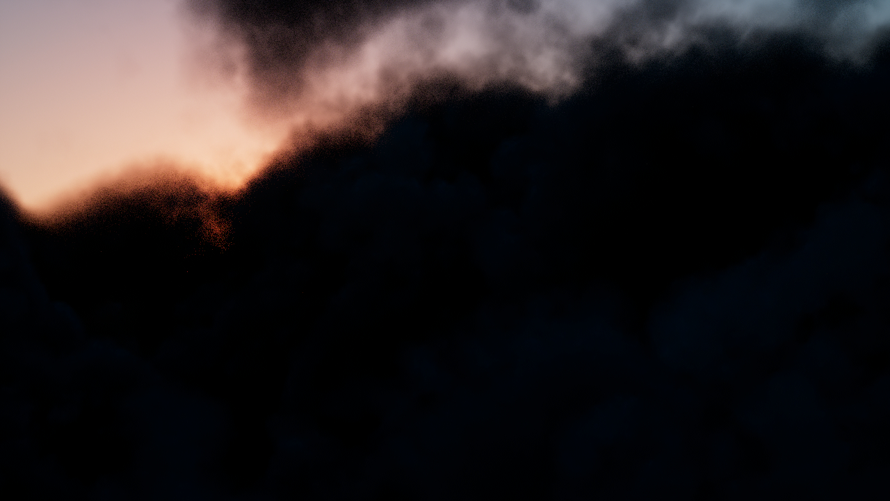

i create a diffuse shader, save the scene, when i load i get this message
"Load warnings for C:/Users/xxxx/Desktop/untitled.hip
Warning: Problem while synchronizing child node:
Warning: Unknown channel(s) "edgesRounding" converted to spare parameter(s).
[/shop/octane_diffuse1/octane_vopnet/NT_MAT_DIFFUSE1]"

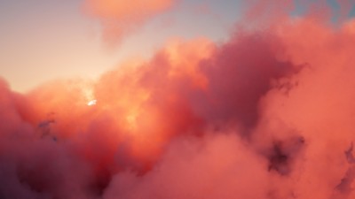

I worked yesterday with volumes, when I load all 5 scenes i generated, i get this kind of message and all my volume shading is broken. like the sun doesn't affect volumes.
