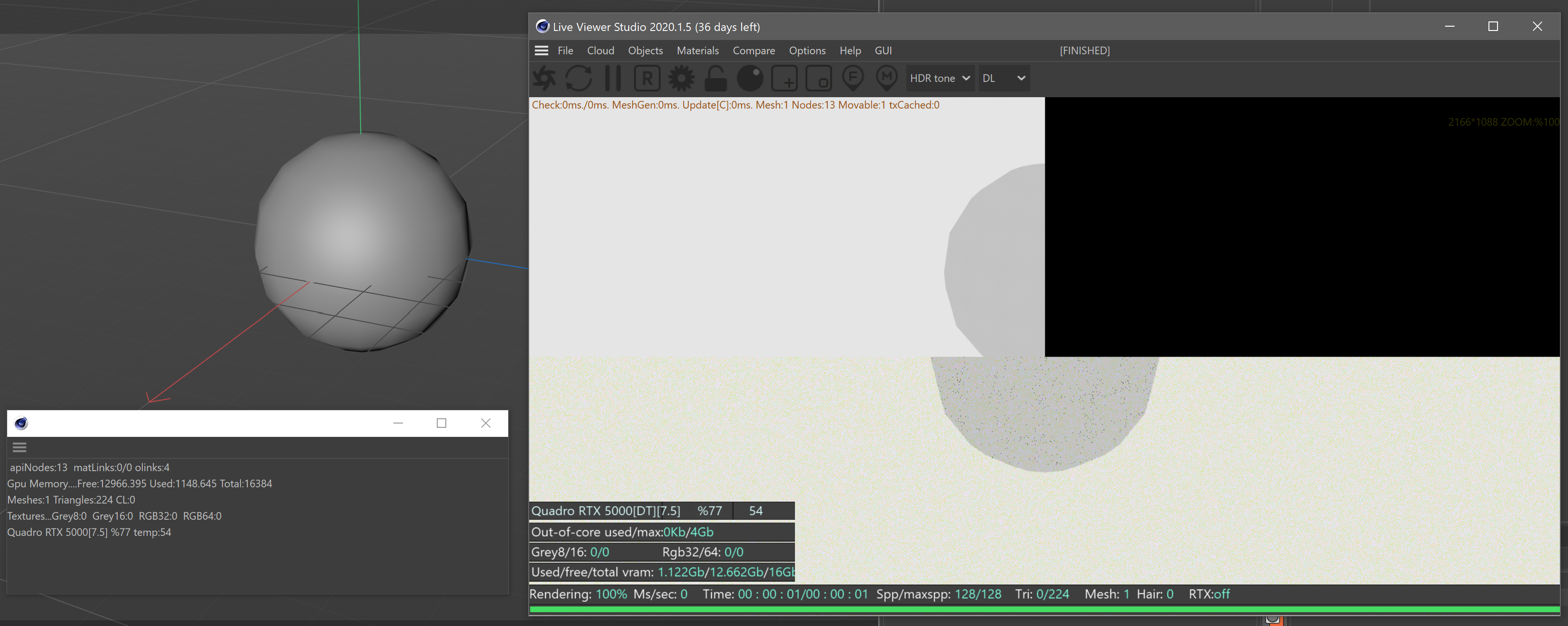

Hello,
Just installed a fresh version of Octane with C4D S22, have up to date studio drivers, but when I fire up the live viewer only 1/4 updates, the rest hangs.
Any idea how to fix it?
If I enable viewport rendering I don't have this problem.

What's screen resolution and OS? Using scaled desktop?
Posts: 10522
Please, try to set the monitor scale at 100%, are you using a 4k monitor correct?

Yeah, I'm on a 4K 17" laptop with 200%, I see that I don't have the problem when I'm on 100% UI.
Is this a temporary bug or should I get used to the fact that octane doesn't play ball with upscaled interfaces?

coenbrasser wrote:Yeah, I'm on a 4K 17" laptop with 200%, I see that I don't have the problem when I'm on 100% UI.
It happens because 1.5 updated for providing canvas scaling without adopting to pixel aspect ratio(desktop scaling). So not a bug but unsupported feature yet, wait for next versions. I'm away for a while. Try canvas scaling in LV by mouse wheel, icon/font sizing from c4d.
