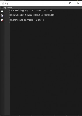

Hi, dear OTOY developers
So, I tried to catch this issue and recorded a video. In the end, you will see it... Sometimes it happens when I change the resolution and sometimes - when I just rotate camera =) Sometimes when just start an IPR =)
Video with the issue -> https://www.youtube.com/watch?v=z7_X_kTdLcM
The scene for investigation -> https://bit.ly/31hDt8T
A. Win 10 2004
B. 2x2080Ti + NVLink
C. 64 GB
D. Latest Nvidia Studio 452.06
E. OctaneRender Standalone version 2020.1.4
F. OctaneRender plugin version (v2020.1.4 - 10.15)
G. 3ds max 2020-2021
Thank you and have a great day
Best regards,
Andrew.

andrey.krivulya wrote:Hi, dear OTOY developers
Hi Andrew,
I couldn't test on my machine, but it seems the new renderer 2020.1.5 solved issues related to Mismatching barriers:
viewtopic.php?f=15&t=75704
3dsMax plugin with 2020.1.5:
viewtopic.php?f=80&t=75730
I hope that helps,
Regards
