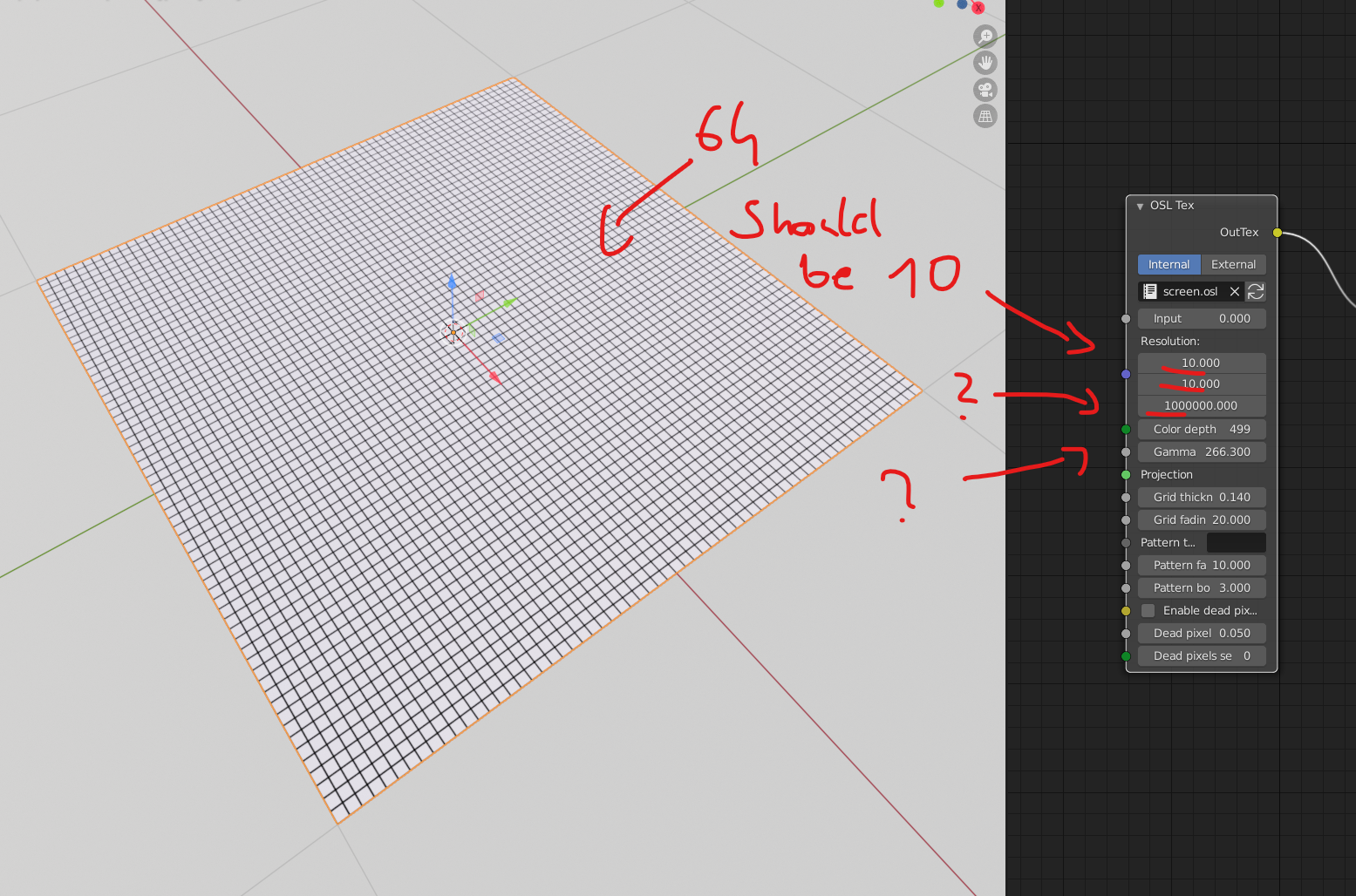

The OSL grid texture from Live DB called "Image to screen" has non functional resolution sliders and not working gamma slider. Same texture works fine in Standalone.

Thanks for your report.
Please attach a scene showing the issue when reporting a problem.

- osl grid issue.blend

21.13 not working too.

Yes, this has not been fixed yet. Not trivial to do that.J.C wrote:21.13 not working too.
