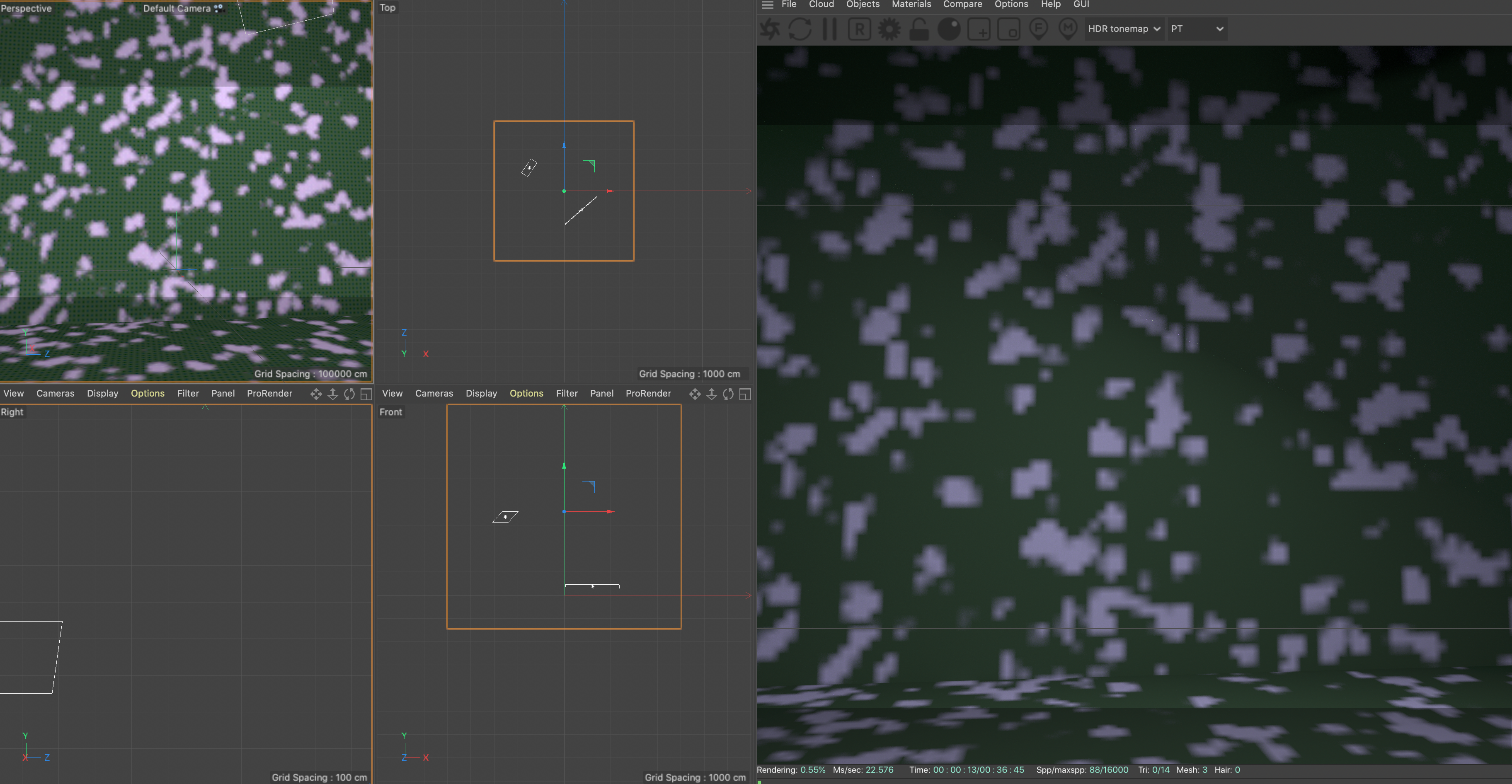

trying to make one of those fancy terrazzo materials I ran into a problem: Octane "pixelates" any C4D noise.
I didn't notice when it was small enough, but it's very noticeable when bigger. I already upped the bake size in the settings without success. How can I avoid that?
Cheers

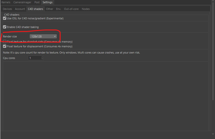

Go to Octane Setting and under C4D shaders, up the render size.

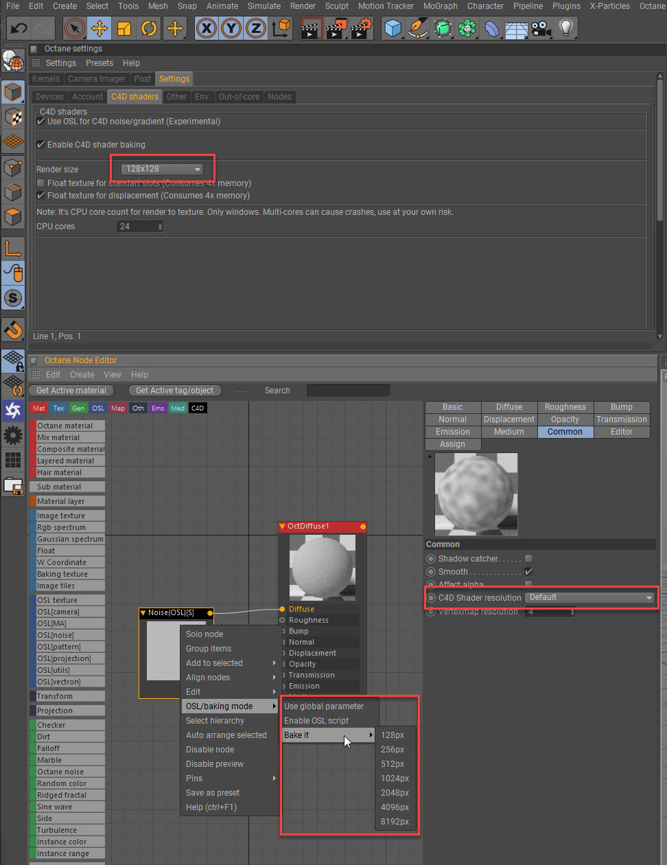

Three options to control it. See image.
1-GLOBAL(settings)
2-Material
3-Texture node in NE menu
Priority ordered from 3. to 1.
