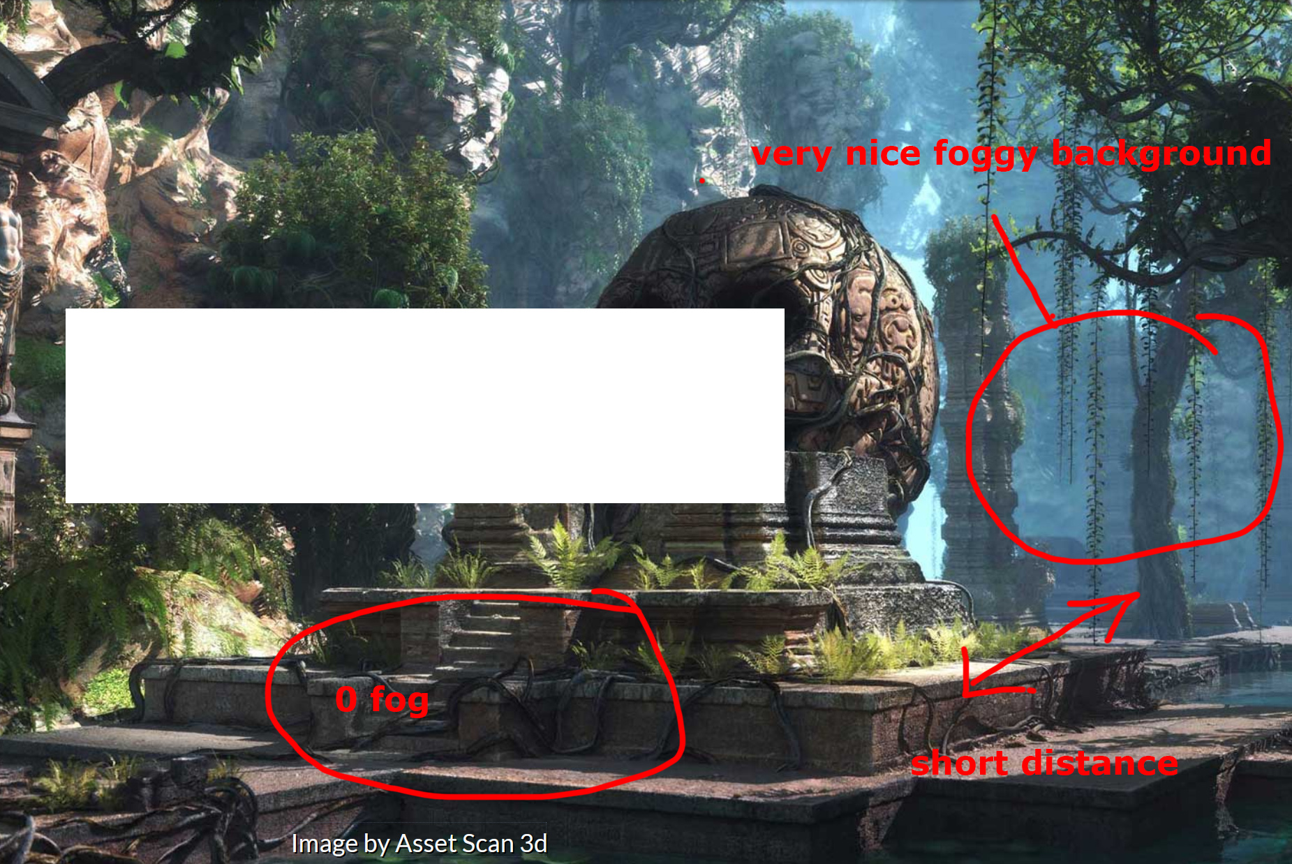

Hi Otoy,
Please look at this image from turbosquid rendered with another engine.
As you can see distance is very short between foreground that has 0 fog and background. The only way I can achieve this with octane is to have 1 mile or more distance between background and foreground. We just want more precise control between them
