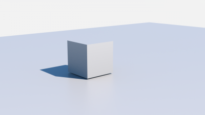

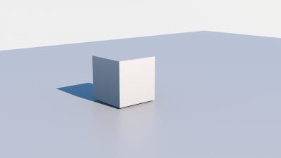

I have a daylight system setup, when I look through the live viewer, it works correctly. But when I hit render animation, it renders correctly the first frame, but then compeletely changes for frame number 2....

Created a new scene. I have all them boxes checked in the animation setting. It changes even with just a cube. So I would say its broken. I am guessing its something to do with the bunch of checkboxes you have to fumble around with.

Here is frame 1 and frame 2 for me.
