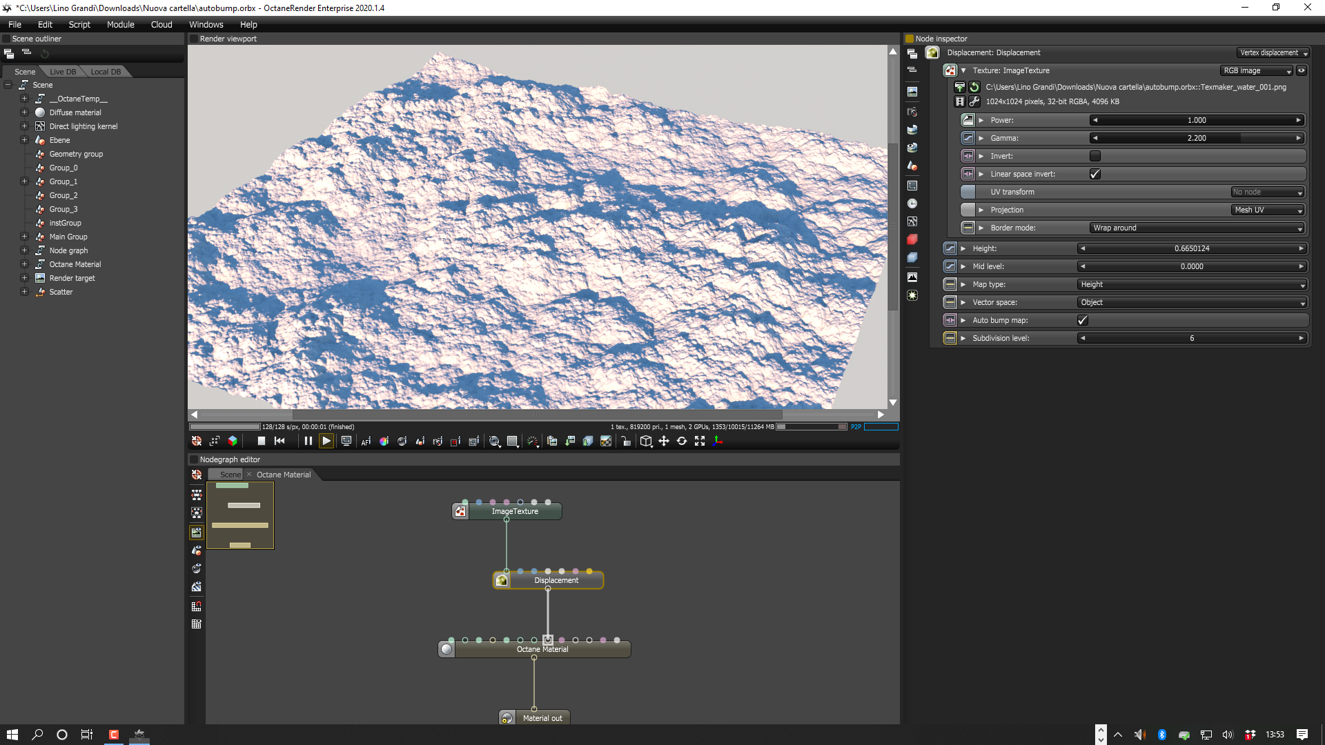

Looks fine in Standalone with RTX on. I'll try to build a similar scene in Cinema.

I've verified in Cinema and we definitely have some problem here. Not happening in Standalone or Octane for Blender, so I guess that's a very specific Cinema issue.
This video shows what happens with Autobump and RTX on:
https://youtu.be/PkfIDjWV2YU
That's the scene:
AutoBump_Issue.zip
(86.47 KiB) Downloaded 202 times
