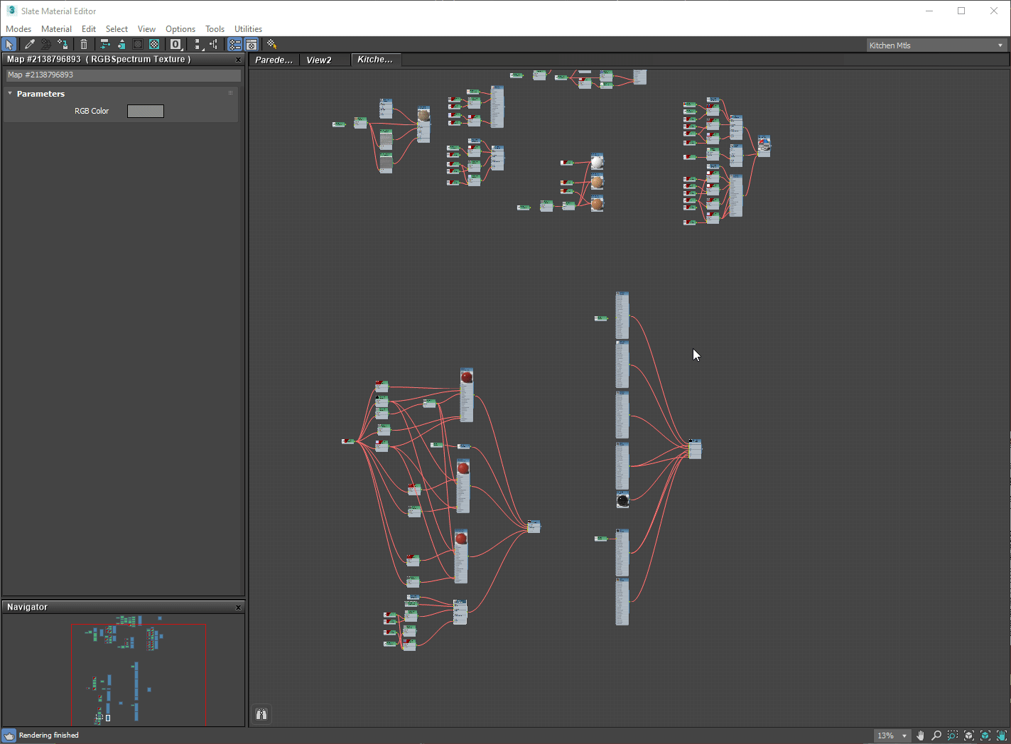

this is a very annoying problem
samsue
Posts: 390
this is the second time I've reported this problem after 1 month ...

neonZorglub , if you don't care, at least you could give a little bit of a response "I don't know what this is or this is something 3ds max not octane related"
at least it would keep a good impression

Hi samsue,
at the moment we could not reproduce that issue, we're investigating around.
Are you using 3dsMax 2021? Release?
Regards
samsue
Posts: 390
Hi paride4331,
3DS Max - 2021.1 / 23,0 -23.1.0.1314
Whenever I'm rendering with OctaneRender Viewport this issue occurs. It's also something new to me this issue, but it's hard to know whether it's because of the nvidia driver, 3ds max or octane ...

Hi samsue,
I have not your issue using 2021.1 / 23,0 -23.1.0.1314 version.
Could you share a scene where the issue could occurs?
Regards
Paride
