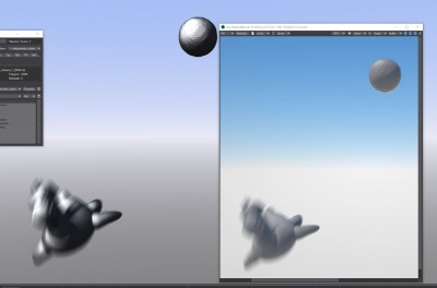

We are able to get the db&w vector displacement motionblur to happen with obj sequence from Houdini using ODTools. We are now trying the same pipeline using EffectiveTDs Storm 0.5.0. We sim in Storm, export obj sequence with v attribute and apply the db&w vector displacement in LW but it only seems to work in the lightwave native VPR, not in Octane (IPR or F10). Any ideas on what we might be missing? (We do indeed have displacement blur checked in Octane render target). We are also asking the guys at EffectiveTDs if they have any ideas:)
