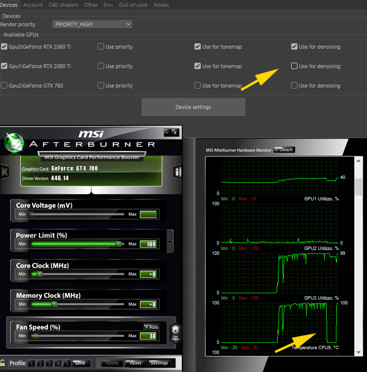

I'm in a multiple GPU configuration and I've noticed that if I allocate only one GPU to the Denoising Process (that till today I thought the best Otoy suggested choice), the other GPU's often goes to 0% of usage when rendering.

Hi Beppe, here my test enabling only the second GPU.
I have noticed that this time is the first GPU that goes to 0%, but more often and for a smaller period (about 3 seconds).
I give you other pieces of information, for your better investigations:
1) I use the Game Driver 446.14 for the reason you mentioned (my 780 isn't recognized with Studio Driver), but I am able to load also the Studio Driver forcing the System to set a GTX 1050 instead of RTX780. So, if you consider it useful, I can make the same test loading Studio Driver.
2)Another thing that could be important: I have to use NVIDIA MSI mode utility (https://nvidia.custhelp.com/app/answers ... tchdog%20v) in order to fix the "watchdog violation error " that I had on my Windows 10 system with a PLX Motherboard. I don't know if in some way this influences the GPU behavior.
