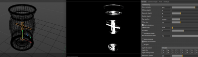

You can still do it the old-fashioned way and put a luminous material on the objects in question, then render a pass in the dark. It can be pretty quick, since only the specular rays need to have significant depth.
Refracted Object Matte
