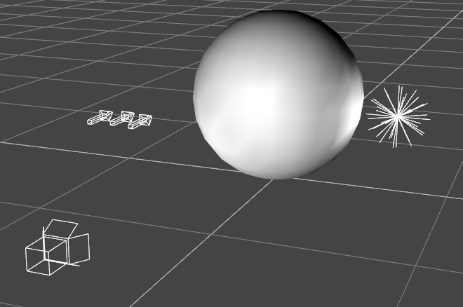

Hi guys, I downloaded the free version of Octane for Daz Studio, everything is simple and easy to understand, but Octane just ignores any types of light sources in Daz Studio other than environment lighting, such as HDR, sky/sun. I tested with a clean scene, a standard sphere, I kept everything as simple as possible. When I throw a distant light, point light, spotlight, Octane doesn't show any changes.
All the software and drivers are updated.
Any tips? Thanks a lot!
a sphere and 3 types of lights

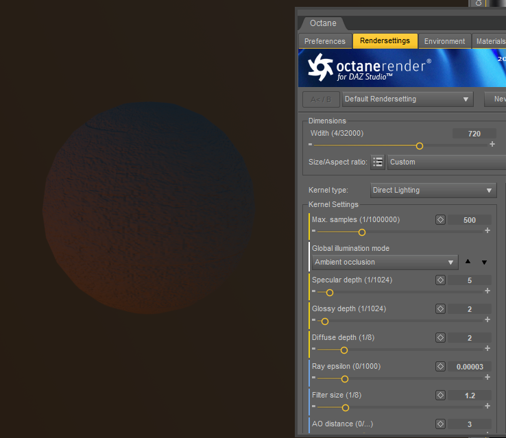

Octane render, the physical sky set to late sunset. I tried all different kernel types, global illumination modes, I tried turning on/off "AI light" and "AI light update". No difference.
