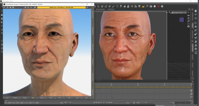

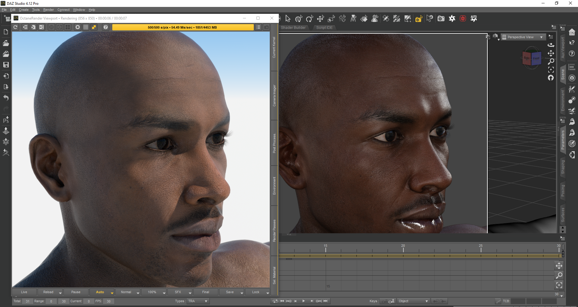

Hi Paul, thanks for the great work on the Octane plugin for DAZ Studio.
I have a quick question, is it possible to have a one to one texture look and feel for the character shaders in Iray? Octane tries to convert the Iray materials but when compared, it looks like there is something lacking. Is there a setting we might be missing? or this is what we can expect for the characters to look like after the default conversion?

solomon wrote:Hi Paul, thanks for the great work on the Octane plugin for DAZ Studio.
The attachment Screenshot 2020-07-20 09.51.56.png is no longer available
The attachment Screenshot 2020-07-20 10.10.37.png is no longer available
1)
The auto-conversion will usually not give you the results you want. Especially with skin materials, you almost always have to adjust the bump strenght (usually 0.05-0.15 are good values) as well as the specular roughness (0.2-0.5 are the usual values). Another big thing to keep in mind is the lighting. Octane cannot convert Iray lights, but you can use HDRIs and emissive geometry. The daylight light you use in your pictures makes characters look flat more often than not. Try to use HDRIs and emissive planes.
2)
Looking at your characters eyes, it seems there are some artifacts. Set the ray-epsilon value in the render settings to its minimum value to prevent this.
3)
Make sure that the Surface Material Filter (in the preferences tab) is empty. By default, i think cornea and eylashes are filtered out and not rendered. I attached a picture to show you what it should look like

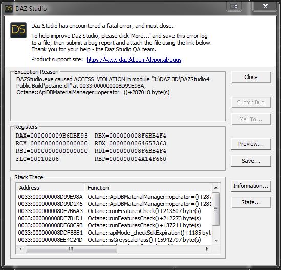

I have a problem came back to daz after a week of being away and not daz crashes on startup
it happens with version 2020_1_0_54 and 2020_1_0_55 but works with 2019_1_4_46
i am on win7 i7 6700k and 64gb ram and a 1070gts and a 2070s with latest nvidia driver and i had no crash over a week ago at all i have no clue what happen.
This looks similar to the other crashes that users have reported. Otoy may have resolved it in 2020.1.4. I will post a build here shortly.
