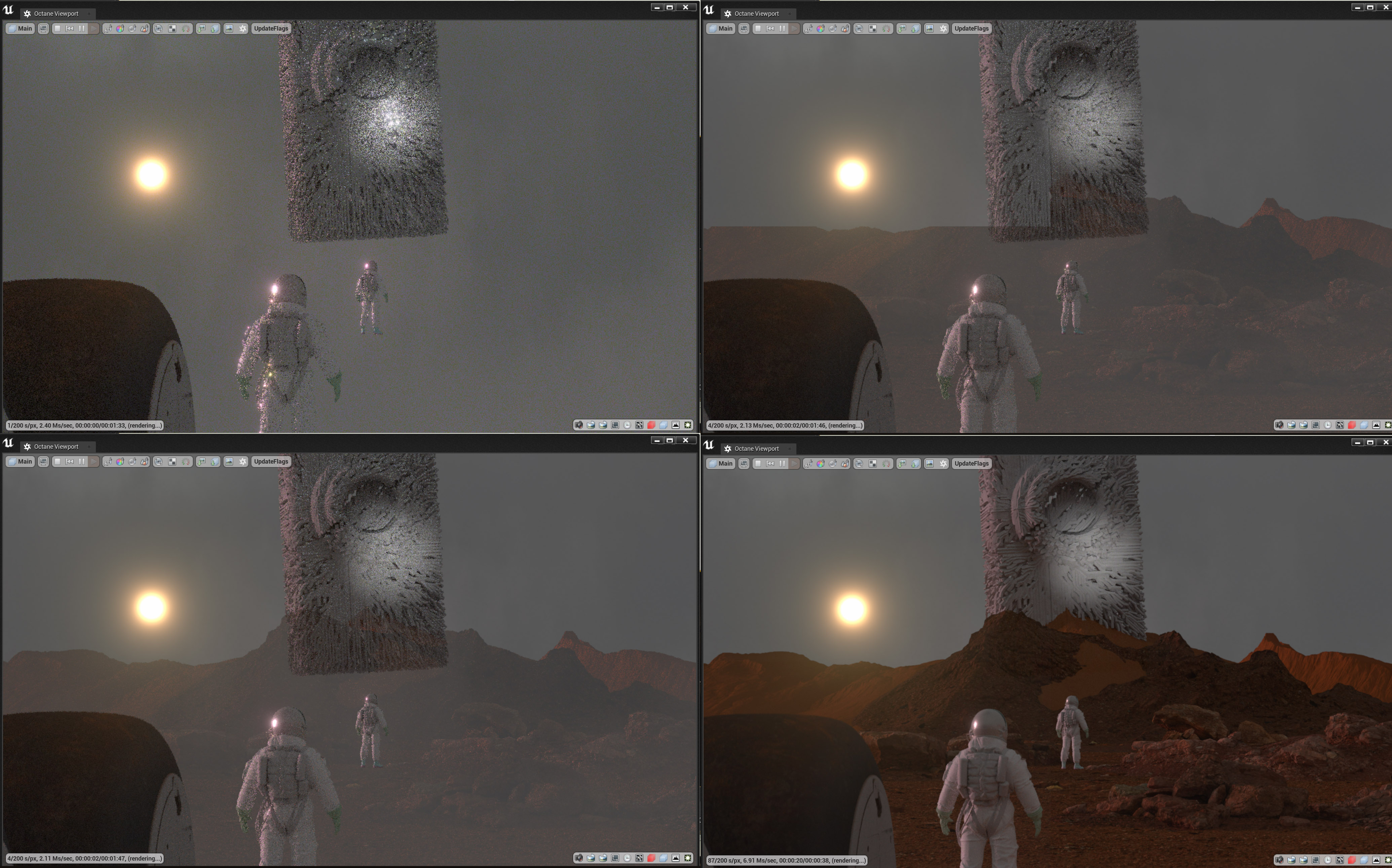

one thing that is driving me crazy is the disappearing of objects in live view for example. i am using assets from my an external HD.
this did not happen with previous versions but lately when i move the camera, the objects disappear for the first few sampling passes, then slowly fade in through the sampling process.
i previously thought this is an orbx problem but it happens with every asset with displacement maps.

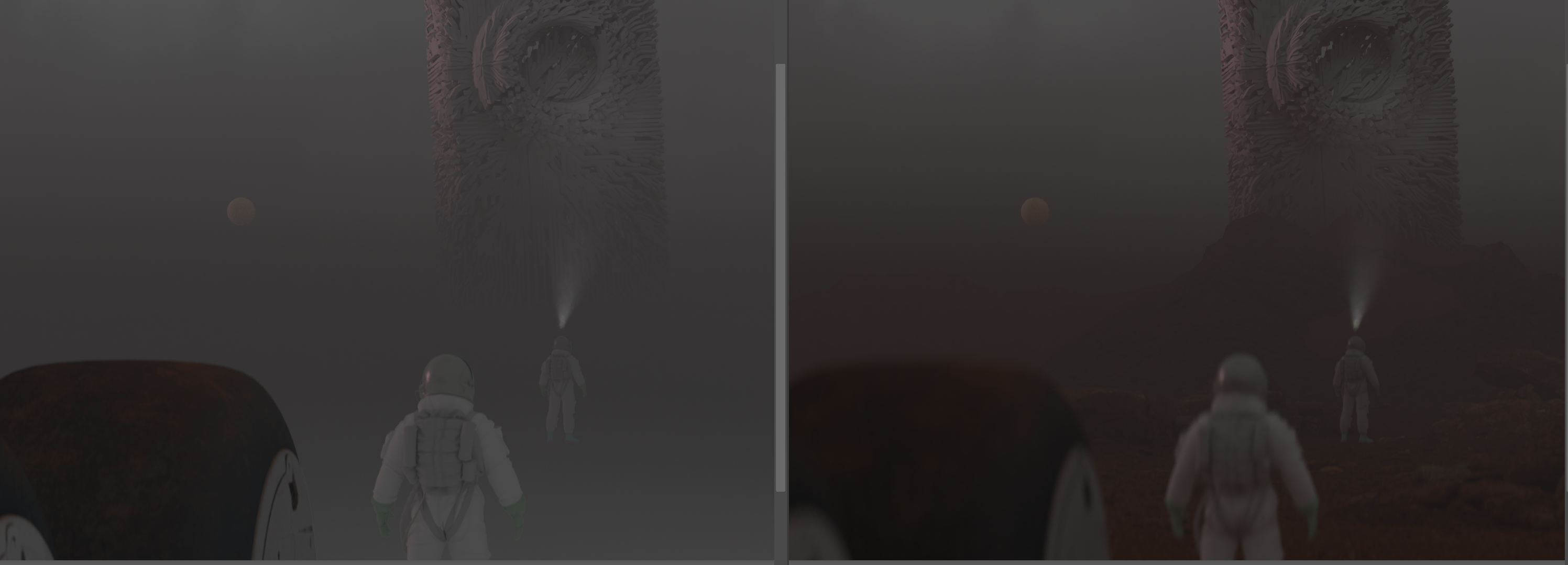

when i try to export the sequence, the first frame does not even show any of the displaced objects, but the second does.
i am attaching the screenshot of the frame 1 and frame 2.
also as you can see the focus shifts aswell, which is a problem i am having all of the time.
sometimes the focus settings get ignored or change on their own. i am trying to understand the problem and will post separately.
the live viewer issue is incredibly annoying and quite a show stopper. attached is the progression of the sampling process so you can see the issue in 4 screengrabs.
this happens when i pick an object and move it even slightly. all of the elements blitz out.
its unworkable honestly.
Posts: 10519
there is a known issue with Displacement in the latest 2020.1.3 SDK, and will be fixed in the next update 2020.1.4.
